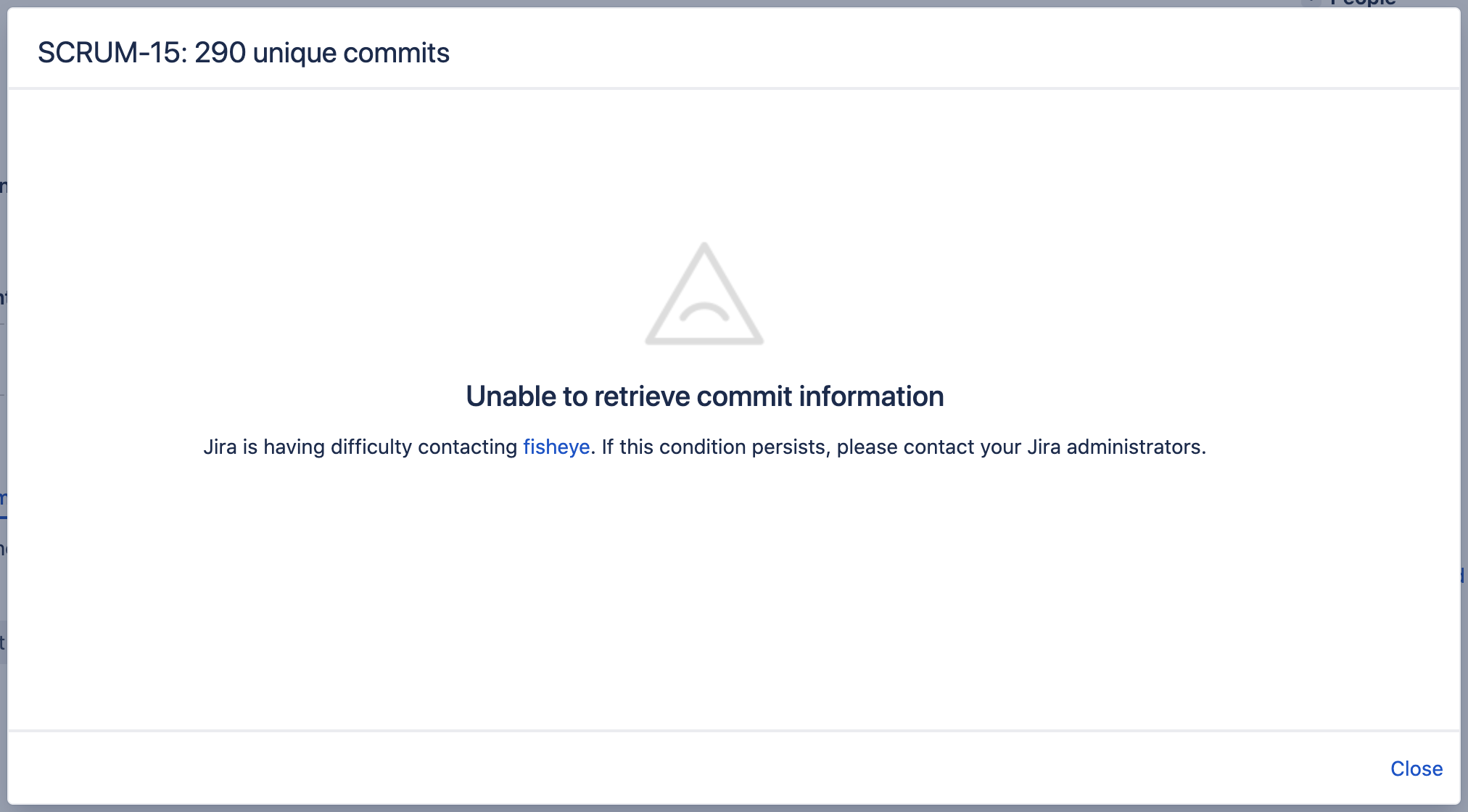

Fisheye commits fail to be displayed inside a Jira issue with the following message:
Unable to retrieve commit information
Jira is having difficulty contacting <FISHEYE_INSTANCE_NAME>. If this condition persists, please contact your Jira administrators.

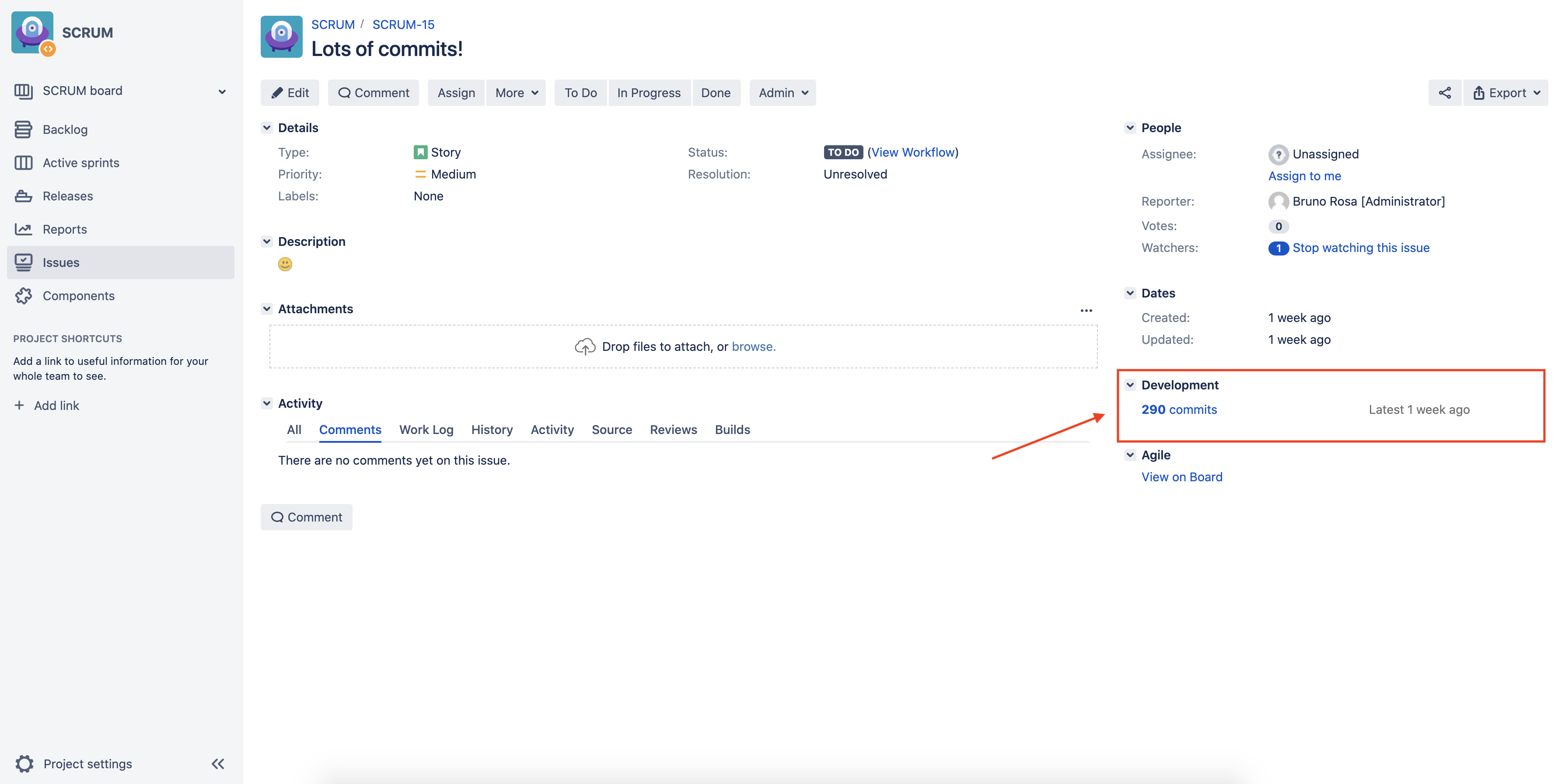

  • You may see that Jira issues with a relatively small number of commits (< 10) don't exhibit any problems loading the commit details while Jira issues with a relatively large number of commits (> 150) do.
  • While there's no restriction to the number of commits that can be linked to a Jira issue, there is a timeout in place for the Development panel of 10000ms (10 seconds). This is the time it has to retrieve all the information about commits linked to your Jira issue from Fisheye. If the operation takes longer than that, it times out.
  • The GET request made to <JIRA_BASE_URL>/rest/dev-status/1.0/issue/detail?issueId=3225186&applicationType=fecru&dataType=repository returns the following error when it times out (this can diagnosed by taking a HAR file when clicking the commits link under the Development panel)
