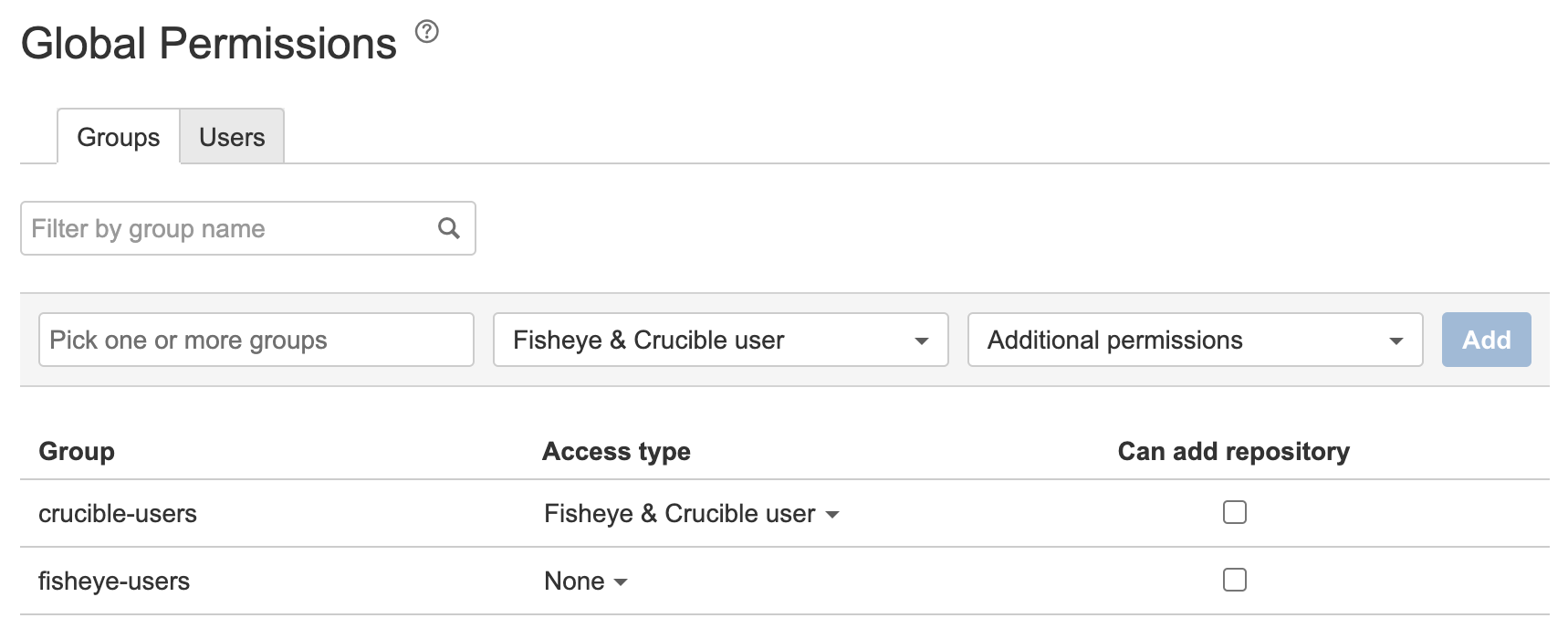

By default, the Global Permissions in Fisheye & Crucible include the default groups: fisheye-users and crucible-users.
If all groups and users—default or custom—Access type was changed to None, all users associated with the removal would lose their license to authenticate.
ℹ️ Note that the example is using the default configuration. As such, only the crucible-users and fisheye-users are listed in the global permissions. There are no users defined on the Users tab.

    # The results are for the image above {"start":0,"limit":100,"lastPage":true,"size":1,"values":[{"name":"crucible-users","permissions":["CRUCIBLE_USER","FISHEYE_USER"]}]}
    ℹ️ Note that the image shows a single group with global permissions, and the API results show the same group with global permissions. In the context of this issue, all groups and users were removed; therefore, no groups or users would return.
