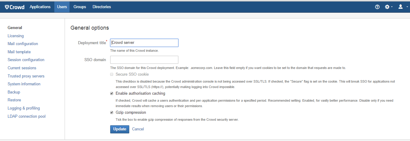

Possible cause and Diagnosis steps:
  • The fact that users are able to log in to an application is an evident that the seraph-config.xml and the crowd.properties configuration are good.
  • Issue would be the domain name settings from the UI level
Configuration needed to be checked:
  • Check the domain name from Crowd Admin > General > General Options
    • SSO Domain should not be left empty
    • SSO Domain should comply with the guide stated in the following documentation:

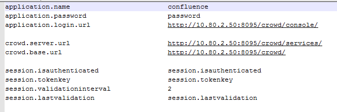

  • The fact that users are not able to log in to an application is an evident that seraph-config.xml and the crowd.properties configuration may not be correct.
  1. Ensure that each Atlassian application's WEB-INF/classes/seraph-config.xml file is using the Crowd's com.atlassian.crowd authenticator class.
  2. In the crowd.properties file, make sure that the application URL from each application (such as Confluence/JIRA) is set to Crowd's IP address instead of Crowd's base URL
