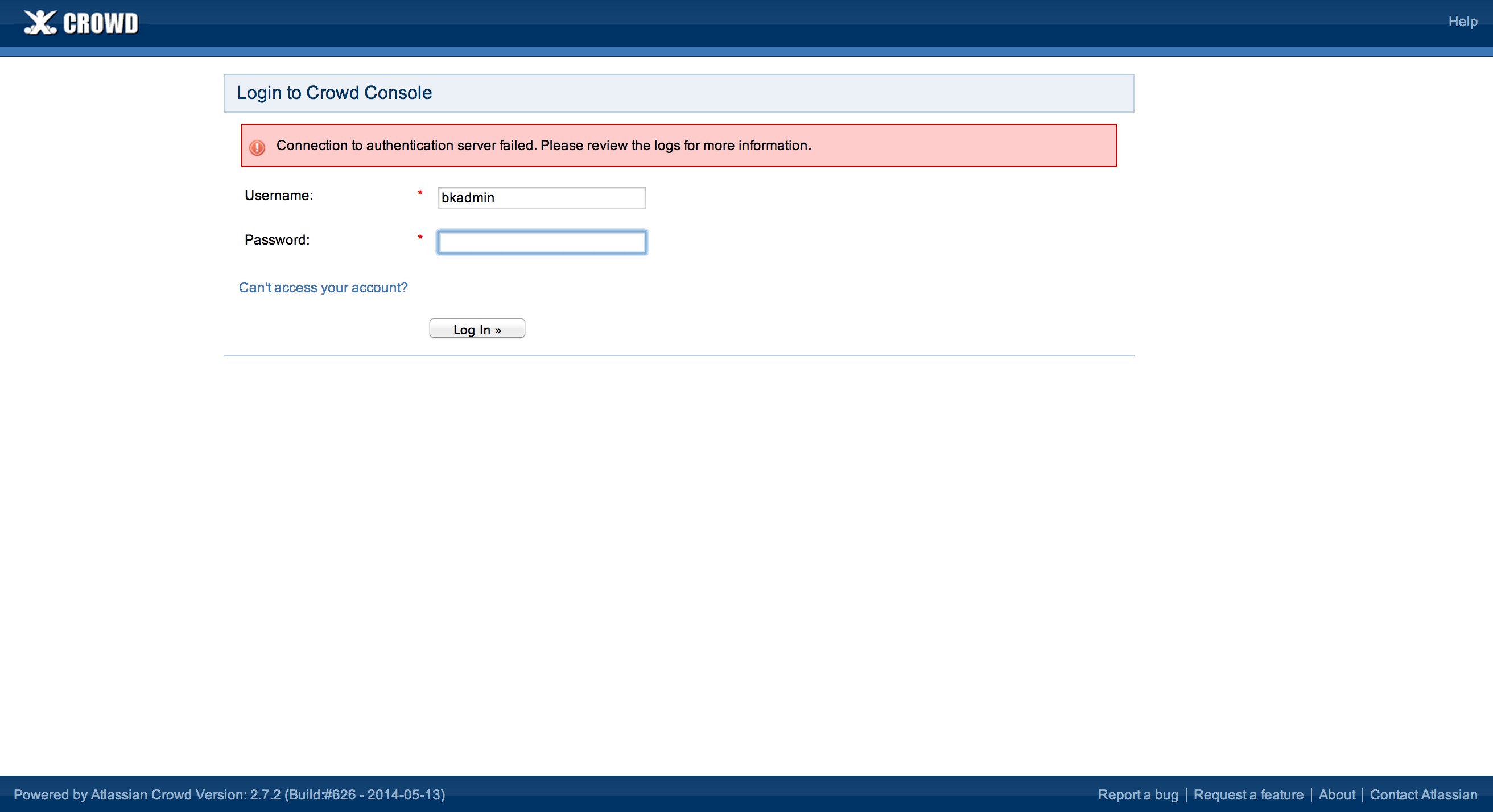

The authentication process into Crowd hangs and then fails with the message: Connection to authentication server failed. Please review the logs for more information.
Subsequent log in attempts with the same credentials are successful without the same hang. However, logging out, waiting at least 10 minutes, and then logging in again produces the same behavior with an initial hang, then subsequent success.
The following appears in the atlassian-crowd.log:
1 2 3 4 5 6 7 8 9 10 11 12 13 14 15 16 17 18 19 20 21 22 23 24 25 26 27 28 29 30 31 32 33 34 35 36 37 38 39 40 41 42 43 44 45 46 47 48 49 50 51 52 53 54 55 56 57 58 59 60 61 62 63 64 65 66 67 68 69 70 71 72 73 74 75 76 77 78 79 80 81 82 83 84 85 86 87 88 89 90 91 92 93 94 95 96 97 98 99 100 101 102 103 104 105 106 107 108 109 110 111 112 113 114 115 116 117 118 119 120 121 122 123 124 125 126 127 128 129 130 131 132 133 134 135 136 137 138 139 2014-08-08 12:13:18,068 http-bio-8095-exec-10 ERROR [xfire.transport.http.HttpChannel] java.net.SocketTimeoutException: Read timed out 2014-08-08 12:13:18,069 http-bio-8095-exec-10 INFO [service.soap.client.SecurityServerClientImpl] Existing application token is null, authenticating ... 2014-08-08 12:13:19,305 http-bio-8095-exec-10 INFO [service.soap.client.SecurityServerClientImpl] Created new application token: X7tupe00MAGxJ0Hahq4euA00 2014-08-08 12:13:19,339 http-bio-8095-exec-16 ERROR [crowd.console.action.Login] Failed to connect to the authentication server, please check your crowd.properties org.springframework.security.authentication.AuthenticationServiceException: Could not invoke service.. Nested exception is org.codehaus.xfire.fault.XFireFault: Couldn't send message. at com.atlassian.crowd.integration.springsecurity.CrowdAuthenticationProvider.translateException(CrowdAuthenticationProvider.java:301) at com.atlassian.crowd.integration.springsecurity.CrowdAuthenticationProvider.authenticateUsernamePassword(CrowdAuthenticationProvider.java:164) at com.atlassian.crowd.integration.springsecurity.CrowdAuthenticationProvider.authenticate(CrowdAuthenticationProvider.java:102) at org.springframework.security.authentication.ProviderManager.authenticate(ProviderManager.java:156) at com.atlassian.crowd.integration.springsecurity.DynamicProviderManagerImpl.authenticate(DynamicProviderManagerImpl.java:40) at org.springframework.security.web.authentication.UsernamePasswordAuthenticationFilter.attemptAuthentication(UsernamePasswordAuthenticationFilter.java:94) at org.springframework.security.web.authentication.AbstractAuthenticationProcessingFilter.doFilter(AbstractAuthenticationProcessingFilter.java:195) at org.springframework.security.web.FilterChainProxy$VirtualFilterChain.doFilter(FilterChainProxy.java:342) at org.springframework.security.web.authentication.logout.LogoutFilter.doFilter(LogoutFilter.java:105) at org.springframework.security.web.FilterChainProxy$VirtualFilterChain.doFilter(FilterChainProxy.java:342) at org.springframework.security.web.context.SecurityContextPersistenceFilter.doFilter(SecurityContextPersistenceFilter.java:87) at org.springframework.security.web.FilterChainProxy$VirtualFilterChain.doFilter(FilterChainProxy.java:342) at org.springframework.security.web.FilterChainProxy.doFilterInternal(FilterChainProxy.java:192) at org.springframework.security.web.FilterChainProxy.doFilter(FilterChainProxy.java:160) at org.springframework.web.filter.DelegatingFilterProxy.invokeDelegate(DelegatingFilterProxy.java:343) at org.springframework.web.filter.DelegatingFilterProxy.doFilter(DelegatingFilterProxy.java:260) at com.atlassian.crowd.console.filter.CrowdDelegatingFilterProxy.doFilter(CrowdDelegatingFilterProxy.java:38) at org.apache.catalina.core.ApplicationFilterChain.internalDoFilter(ApplicationFilterChain.java:243) at org.apache.catalina.core.ApplicationFilterChain.doFilter(ApplicationFilterChain.java:210) at com.atlassian.crowd.console.filter.LoginCsrfFilter.doFilterInternal(LoginCsrfFilter.java:47) at org.springframework.web.filter.OncePerRequestFilter.doFilter(OncePerRequestFilter.java:107) at org.springframework.web.filter.DelegatingFilterProxy.invokeDelegate(DelegatingFilterProxy.java:343) at org.springframework.web.filter.DelegatingFilterProxy.doFilter(DelegatingFilterProxy.java:260) at com.atlassian.crowd.console.filter.CrowdDelegatingFilterProxy.doFilter(CrowdDelegatingFilterProxy.java:38) at org.apache.catalina.core.ApplicationFilterChain.internalDoFilter(ApplicationFilterChain.java:243) at org.apache.catalina.core.ApplicationFilterChain.doFilter(ApplicationFilterChain.java:210) at com.atlassian.plugin.servlet.filter.IteratingFilterChain.doFilter(IteratingFilterChain.java:46) at com.atlassian.plugin.servlet.filter.DelegatingPluginFilter$1.doFilter(DelegatingPluginFilter.java:66) at com.atlassian.security.auth.trustedapps.filter.TrustedApplicationsFilter.doFilter(TrustedApplicationsFilter.java:98) at com.atlassian.plugin.servlet.filter.DelegatingPluginFilter.doFilter(DelegatingPluginFilter.java:74) at com.atlassian.plugin.servlet.filter.IteratingFilterChain.doFilter(IteratingFilterChain.java:42) at com.atlassian.plugin.servlet.filter.DelegatingPluginFilter$1.doFilter(DelegatingPluginFilter.java:66) at com.atlassian.oauth.serviceprovider.internal.servlet.OAuthFilter.doFilter(OAuthFilter.java:55) at com.atlassian.plugin.servlet.filter.DelegatingPluginFilter.doFilter(DelegatingPluginFilter.java:74) at com.atlassian.plugin.servlet.filter.IteratingFilterChain.doFilter(IteratingFilterChain.java:42) at com.atlassian.plugin.servlet.filter.ServletFilterModuleContainerFilter.doFilter(ServletFilterModuleContainerFilter.java:77) at com.atlassian.plugin.servlet.filter.ServletFilterModuleContainerFilter.doFilter(ServletFilterModuleContainerFilter.java:63) at org.apache.catalina.core.ApplicationFilterChain.internalDoFilter(ApplicationFilterChain.java:243) at org.apache.catalina.core.ApplicationFilterChain.doFilter(ApplicationFilterChain.java:210) at com.atlassian.crowd.console.filter.LicenceFilter.doFilterInternal(LicenceFilter.java:56) at org.springframework.web.filter.OncePerRequestFilter.doFilter(OncePerRequestFilter.java:107) at org.springframework.web.filter.DelegatingFilterProxy.invokeDelegate(DelegatingFilterProxy.java:343) at org.springframework.web.filter.DelegatingFilterProxy.doFilter(DelegatingFilterProxy.java:260) at com.atlassian.crowd.console.filter.CrowdDelegatingFilterProxy.doFilter(CrowdDelegatingFilterProxy.java:38) at org.apache.catalina.core.ApplicationFilterChain.internalDoFilter(ApplicationFilterChain.java:243) at org.apache.catalina.core.ApplicationFilterChain.doFilter(ApplicationFilterChain.java:210) at com.atlassian.johnson.filters.AbstractJohnsonFilter.doFilter(AbstractJohnsonFilter.java:67) at org.apache.catalina.core.ApplicationFilterChain.internalDoFilter(ApplicationFilterChain.java:243) at org.apache.catalina.core.ApplicationFilterChain.doFilter(ApplicationFilterChain.java:210) at org.springframework.orm.hibernate4.support.OpenSessionInViewFilter.doFilterInternal(OpenSessionInViewFilter.java:152) at com.atlassian.crowd.console.filter.CrowdOpenSessionInViewFilter.doFilterInternal(CrowdOpenSessionInViewFilter.java:26) at org.springframework.web.filter.OncePerRequestFilter.doFilter(OncePerRequestFilter.java:107) at org.apache.catalina.core.ApplicationFilterChain.internalDoFilter(ApplicationFilterChain.java:243) at org.apache.catalina.core.ApplicationFilterChain.doFilter(ApplicationFilterChain.java:210) at com.atlassian.crowd.plugin.web.filter.RequestCacheThreadLocalFilter.doFilter(RequestCacheThreadLocalFilter.java:31) at org.apache.catalina.core.ApplicationFilterChain.internalDoFilter(ApplicationFilterChain.java:243) at org.apache.catalina.core.ApplicationFilterChain.doFilter(ApplicationFilterChain.java:210) at com.atlassian.gzipfilter.GzipFilter.doFilterInternal(GzipFilter.java:74) at com.atlassian.gzipfilter.GzipFilter.doFilter(GzipFilter.java:51) at org.springframework.web.filter.DelegatingFilterProxy.invokeDelegate(DelegatingFilterProxy.java:343) at org.springframework.web.filter.DelegatingFilterProxy.doFilter(DelegatingFilterProxy.java:260) at com.atlassian.crowd.console.filter.CrowdDelegatingFilterProxy.doFilter(CrowdDelegatingFilterProxy.java:38) at org.apache.catalina.core.ApplicationFilterChain.internalDoFilter(ApplicationFilterChain.java:243) at org.apache.catalina.core.ApplicationFilterChain.doFilter(ApplicationFilterChain.java:210) at com.atlassian.plugin.servlet.filter.IteratingFilterChain.doFilter(IteratingFilterChain.java:46) at com.atlassian.plugin.servlet.filter.ServletFilterModuleContainerFilter.doFilter(ServletFilterModuleContainerFilter.java:77) at com.atlassian.plugin.servlet.filter.ServletFilterModuleContainerFilter.doFilter(ServletFilterModuleContainerFilter.java:63) at org.apache.catalina.core.ApplicationFilterChain.internalDoFilter(ApplicationFilterChain.java:243) at org.apache.catalina.core.ApplicationFilterChain.doFilter(ApplicationFilterChain.java:210) at org.springframework.web.filter.CharacterEncodingFilter.doFilterInternal(CharacterEncodingFilter.java:88) at org.springframework.web.filter.OncePerRequestFilter.doFilter(OncePerRequestFilter.java:107) at org.apache.catalina.core.ApplicationFilterChain.internalDoFilter(ApplicationFilterChain.java:243) at org.apache.catalina.core.ApplicationFilterChain.doFilter(ApplicationFilterChain.java:210) at com.atlassian.crowd.plugin.web.filter.HttpContextFilter.doFilter(HttpContextFilter.java:34) at org.apache.catalina.core.ApplicationFilterChain.internalDoFilter(ApplicationFilterChain.java:243) at org.apache.catalina.core.ApplicationFilterChain.doFilter(ApplicationFilterChain.java:210) at org.apache.catalina.core.StandardWrapperValve.invoke(StandardWrapperValve.java:222) at org.apache.catalina.core.StandardContextValve.invoke(StandardContextValve.java:123) at org.apache.catalina.authenticator.AuthenticatorBase.invoke(AuthenticatorBase.java:502) at org.apache.catalina.core.StandardHostValve.invoke(StandardHostValve.java:171) at org.apache.catalina.valves.ErrorReportValve.invoke(ErrorReportValve.java:99) at org.apache.catalina.core.StandardEngineValve.invoke(StandardEngineValve.java:118) at org.apache.catalina.connector.CoyoteAdapter.service(CoyoteAdapter.java:408) at org.apache.coyote.http11.AbstractHttp11Processor.process(AbstractHttp11Processor.java:1023) at org.apache.coyote.AbstractProtocol$AbstractConnectionHandler.process(AbstractProtocol.java:589) at org.apache.tomcat.util.net.JIoEndpoint$SocketProcessor.run(JIoEndpoint.java:312) at java.util.concurrent.ThreadPoolExecutor.runWorker(ThreadPoolExecutor.java:1145) at java.util.concurrent.ThreadPoolExecutor$Worker.run(ThreadPoolExecutor.java:615) at java.lang.Thread.run(Thread.java:744) Caused by: org.codehaus.xfire.XFireRuntimeException: Could not invoke service.. Nested exception is org.codehaus.xfire.fault.XFireFault: Couldn't send message. at org.codehaus.xfire.client.XFireProxy.handleRequest(XFireProxy.java:92) at org.codehaus.xfire.client.XFireProxy.invoke(XFireProxy.java:57) at com.sun.proxy.$Proxy318.authenticateApplication(Unknown Source) at com.atlassian.crowd.service.soap.client.SecurityServerClientImpl.authenticate(SecurityServerClientImpl.java:235) at com.atlassian.crowd.service.soap.client.SecurityServerClientImpl.getSoapApplicationToken(SecurityServerClientImpl.java:215) at com.atlassian.crowd.service.soap.client.SecurityServerClientImpl.authenticatePrincipal(SecurityServerClientImpl.java:255) at com.atlassian.crowd.service.cache.CacheAwareAuthenticationManager.authenticate(CacheAwareAuthenticationManager.java:48) at com.atlassian.crowd.integration.http.HttpAuthenticatorImpl.verifyAuthentication(HttpAuthenticatorImpl.java:247) at com.atlassian.crowd.integration.springsecurity.RemoteCrowdAuthenticationProvider.authenticate(RemoteCrowdAuthenticationProvider.java:50) at com.atlassian.crowd.integration.springsecurity.CrowdAuthenticationProvider.authenticateUsernamePassword(CrowdAuthenticationProvider.java:150) ... 87 more Caused by: org.codehaus.xfire.fault.XFireFault: Couldn't send message. at org.codehaus.xfire.fault.XFireFault.createFault(XFireFault.java:89) at org.codehaus.xfire.handler.OutMessageSender.invoke(OutMessageSender.java:30) at org.codehaus.xfire.handler.HandlerPipeline.invoke(HandlerPipeline.java:131) at org.codehaus.xfire.client.Invocation.invoke(Invocation.java:79) at org.codehaus.xfire.client.Invocation.invoke(Invocation.java:114) at org.codehaus.xfire.client.Client.invoke(Client.java:336) at org.codehaus.xfire.client.XFireProxy.handleRequest(XFireProxy.java:77) ... 96 more Caused by: org.codehaus.xfire.XFireException: Couldn't send message. at org.codehaus.xfire.transport.http.HttpChannel.sendViaClient(HttpChannel.java:145) at org.codehaus.xfire.transport.http.HttpChannel.send(HttpChannel.java:48) at org.codehaus.xfire.handler.OutMessageSender.invoke(OutMessageSender.java:26) ... 101 more Caused by: java.net.SocketTimeoutException: Read timed out at java.net.SocketInputStream.socketRead0(Native Method) at java.net.SocketInputStream.read(SocketInputStream.java:152) at java.net.SocketInputStream.read(SocketInputStream.java:122) at java.io.BufferedInputStream.fill(BufferedInputStream.java:235) at java.io.BufferedInputStream.read(BufferedInputStream.java:254) at org.apache.commons.httpclient.HttpParser.readRawLine(HttpParser.java:78) at org.apache.commons.httpclient.HttpParser.readLine(HttpParser.java:106) at org.apache.commons.httpclient.HttpConnection.readLine(HttpConnection.java:1116) at org.apache.commons.httpclient.MultiThreadedHttpConnectionManager$HttpConnectionAdapter.readLine(MultiThreadedHttpConnectionManager.java:1413) at org.apache.commons.httpclient.HttpMethodBase.readStatusLine(HttpMethodBase.java:1973) at org.apache.commons.httpclient.HttpMethodBase.readResponse(HttpMethodBase.java:1735) at org.apache.commons.httpclient.HttpMethodBase.execute(HttpMethodBase.java:1098) at org.apache.commons.httpclient.HttpMethodDirector.executeWithRetry(HttpMethodDirector.java:398) at org.apache.commons.httpclient.HttpMethodDirector.executeMethod(HttpMethodDirector.java:171) at org.apache.commons.httpclient.HttpClient.executeMethod(HttpClient.java:397) at org.codehaus.xfire.transport.http.CommonsHttpMessageSender.send(CommonsHttpMessageSender.java:369) at org.codehaus.xfire.transport.http.HttpChannel.sendViaClient(HttpChannel.java:123) ... 103 more
