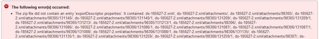

XML backup file restoration failed, and the following is seen from the UI:
Error: Zip file does not contain exportDescriptor.properties.  It contains several XML files and attachments.
The following appears in the atlassian-confluence.log:
2012-08-31 18:58:56,524 ERROR [http-8770-5] [confluence.util.zip.FileUnzipper] unzipFileInArchive The file: exportDescriptor.properties could not be found in the archive: C:\data\confluence\temp\upload_59b7e4d6_1397b8e0951__7f4d_00000010\ds-185627-2.xml.zip

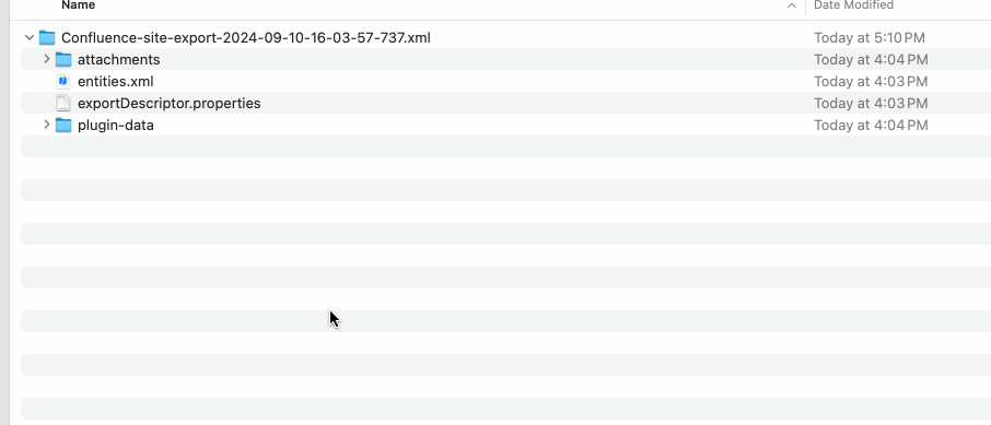

  1. This is a common problem when the exportDescriptor.properties file is:
    1. Missing from the XML backup
    2. OR incorrectly nested inside another sub-folder:
      Incorrect
      /Confluence-site-export-2024-09-10-16-03-57-737.xml/Confluence-site-export-2024-09-10-16-03-57-737.xml/exportDescriptor.properties
      Correct
      ℹ️ This can happen when the files aren't zipped correctly.

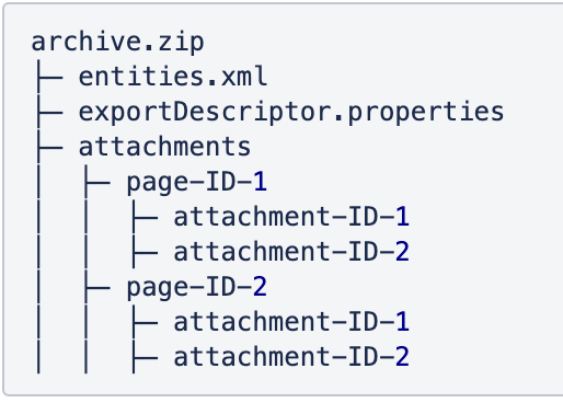

  1. Ensure that the XML backup is valid. It should contain at least the following two files:
    1. exportDescriptor.properties
    2. entities.xml
  2. When recompressing the file:
When recompressing a backup, zip files directly.
Select all files in the subfolder and zip them directly. Avoid zipping the folder itself, as this will nest the contents, preventing Confluence from locating them.

Double-check if the folder structure is as below:
File structure of archive.zip showing entities.xml, exportDescriptor.properties, and attachments sorted by page ID.  Each page has two attachments.
