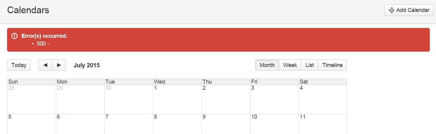

When attempting to view Team Calendars for Confluence, users receive a 500 error as shown below:
