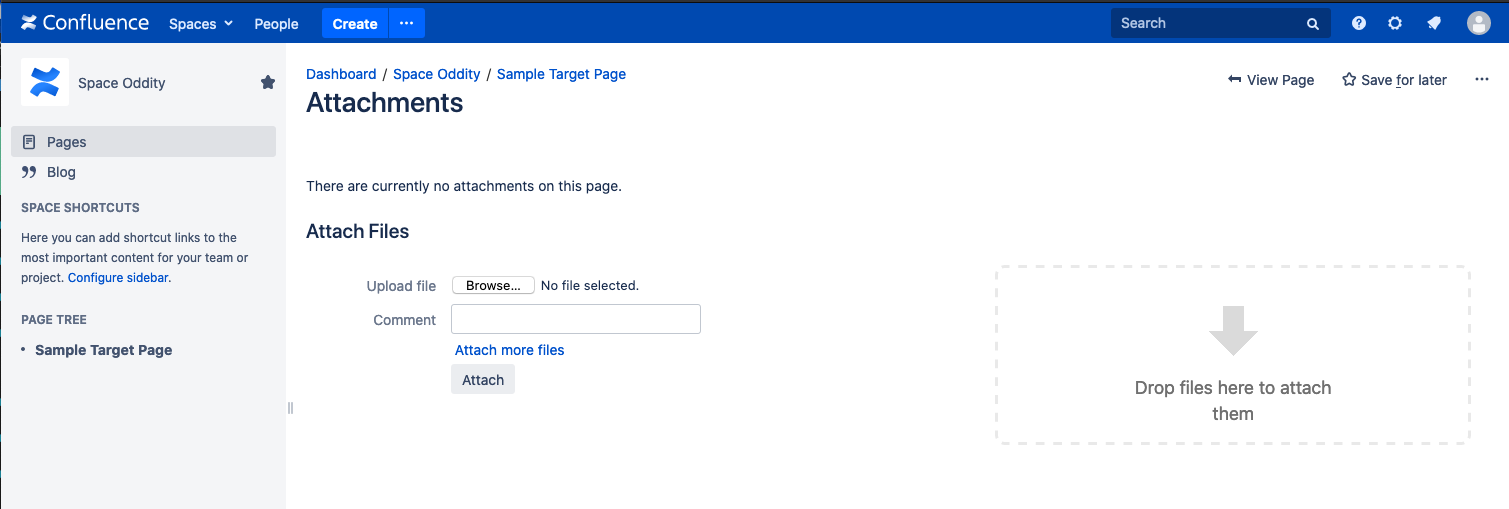

Please note that at this point, the attachment will not yet be added to the page content as this would be the equivalent of uploading the attachment using the UI as shown below:

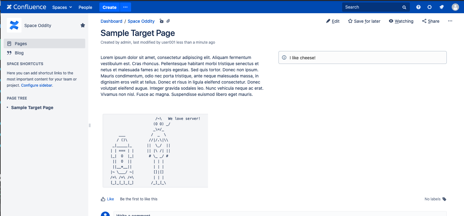

If we take a look at the page after this has been performed, then we'll see the image in the page content.
