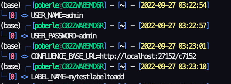

Define environment variables
These variables will be used along with the subsequent commands.
Some notes about these variables:
  • Make sure the user performing these changes has the appropriate Space Permissions and, if applicable, Page Restrictions. Note that Confluence REST API follows the same permissions/restrictions when the user is performing similar operations from the UI (browser).
  • The CONTENTID of the target attachment should be known. For instance, the query below can help retrieve the CONTENTID for the current attachments in the Confluence site
    Retrieve current attachments definition from the database
    1 SELECT * FROM CONTENT WHERE CONTENTTYPE='ATTACHMENT' and CONTENT_STATUS='current';
Code
1 2 3 4 USER_NAME=<username> # the user must have the necessary permissions on the target page and space where the attachment is located USER_PASSWORD=<user password> CONFLUENCE_BASE_URL=<Confluence Base URL> LABEL_NAME=<the_label_to_add_to_attachment>

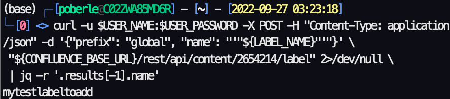

First, we will validate the model by adding the label to one attachment. This is accomplished by sending a POST request to the /rest/api/content/<CONTENTID>/label API method.

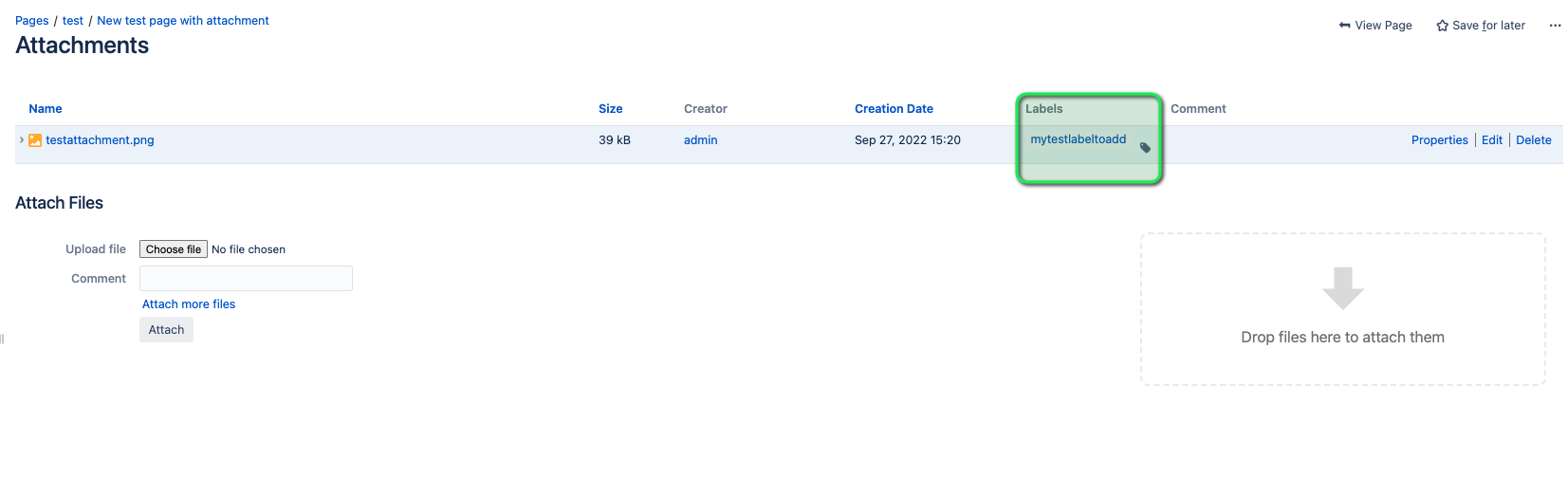

The results of this API call are filtered to get the last label added to the attachment which should be the name of the label. This indicates that the operation succeeded. Let's assume in our example we have retrieved the CONTENTID for our attachment which is 2654214
Code
1 2 3 curl -u $USER_NAME:$USER_PASSWORD -X POST -H "Content-Type: application/json" -d '{"prefix": "global", "name": "'"${LABEL_NAME}"'"}' \ "${CONFLUENCE_BASE_URL}/rest/api/content/2654214/label" 2>/dev/null \ | jq -r '.results[-1].name'
