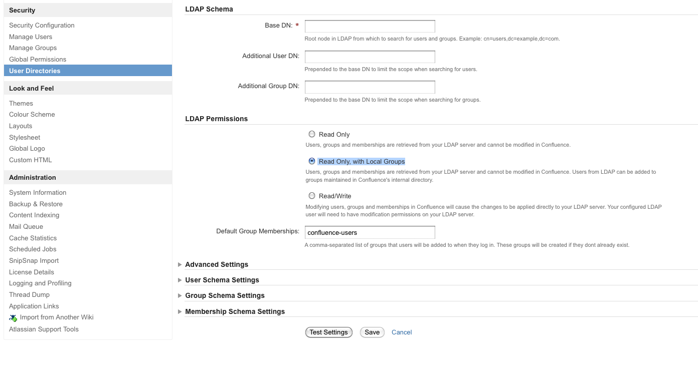

Resolution
Login as a confluence administrator:
  1. Go to the 'Administration Console' and click 'User Directories' in the left-hand panel.
  2. A user list of user directories will be shown Click 'Edit' next to the directory you want to have users automatically added to a group.
  3. Under the 'LDAP Permissions' section, ensure the 'Read Only with Local Groups' option is selected.
  4. Then type in the group name in the 'Default Group memberships' field (eg 'confluence-users').
  5. Click the 'Test Settings' then the 'Save' button at the bottom of the screen.
