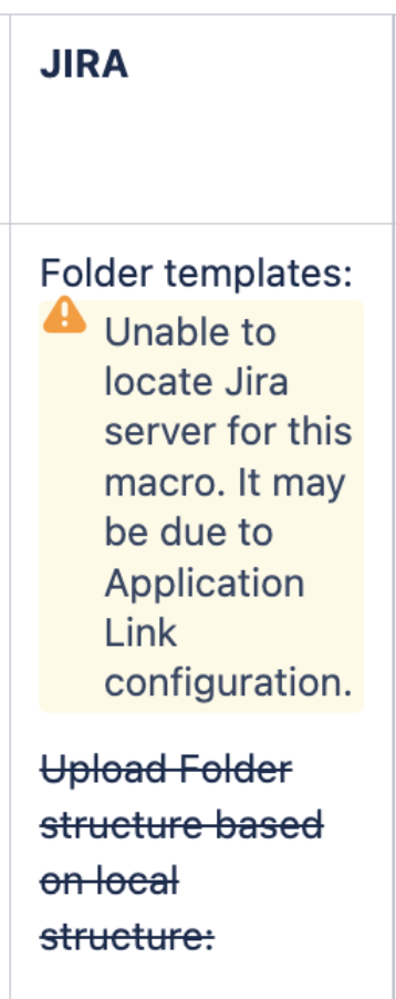

When Confluence makes a connection with other applications like Jira using the Jira issue filter macro, it fetches the destination application metadata, for example ( ServerId & ServerName ). Here is an example of one of the Jira issue code snippets from the page storage format:
<ac:structured-macro ac:macro-id="9325964b-61c2-45e6-979c-0fa8365c6901" ac:name="jira" ac:schema-version="1"> <ac:parameter ac:name="server">SAP Projects</ac:parameter> <ac:parameter ac:name="serverId">1e9faecf-27de-35b4-9422-9d9d1169451f</ac:parameter> <ac:parameter ac:name="key">CE-4704</ac:parameter> </ac:structured-macro> → Assign Follow-up/Related Items to an email</li>
Here "1e9faecf-27de-35b4-9422-9d9d1169451f" is the serverID and SAP Projects is the ServerName. These values can be validated with the application Link detail:
<application-links> <id>92470b9e-cf72-375e-b312-cdf19f545a56</id> <name>JIRA</name> <primary>true</primary> <type>applinks.jira</type> <display-url>https://testjira.com/jira</display-url> <rpc-url>https://testjira.com/jira</rpc-url> </application-links> </application-links>
As both IDs are mismatching that means Confluence has a Jira app link connected to the latest Jira server after Jira server migration. But Confluence pages are still pointing to the old Jira server using the old Jira serverID and Jira server Name. With this mismatch, we started seeing the following error in the Confluence page with the Jira application link.
