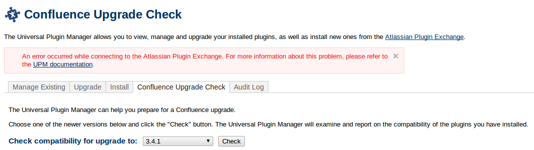

The following error is shown after doing an upgrade check in UPM:
1 An error occurred while connecting to the Atlassian Plugin Exchange. For more information about this problem, please refer to the [UPM documentation|http://confluence.atlassian.com/display/UPM/Problems+Connecting+to+the+Atlassian+Plugin+Exchange].
