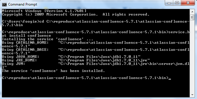

The Confluence Windows Service installation is successful:

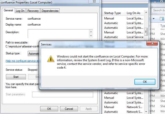

But the startup fails with this:
There are no commons-daemon log generated in ConfluenceInstallation/logs
(this is normally the logs used to identify the service-related error.
