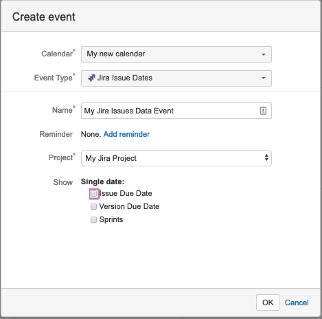

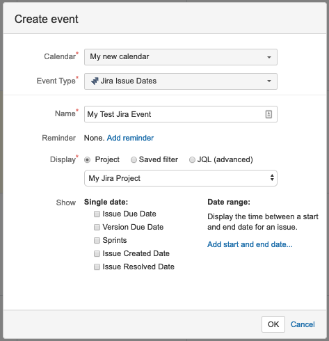

An admin has integrated Confluence & Jira successfully and is attempting to leverage Jira Issue Dates as a means of creating Team Calendar events. The crux of the problem is two fold:
  1. When the admin reaches the create event modal in Confluence, the Jira options that should be shown do not appear for any users
  2. When the admin attempts to create an event off of the available options (issue date, version due date or sprints) the calendar event is not created nor added to the calendar.
A sample of what the admin may see in contrast to what the admin should see:
Incorrect
Correct
