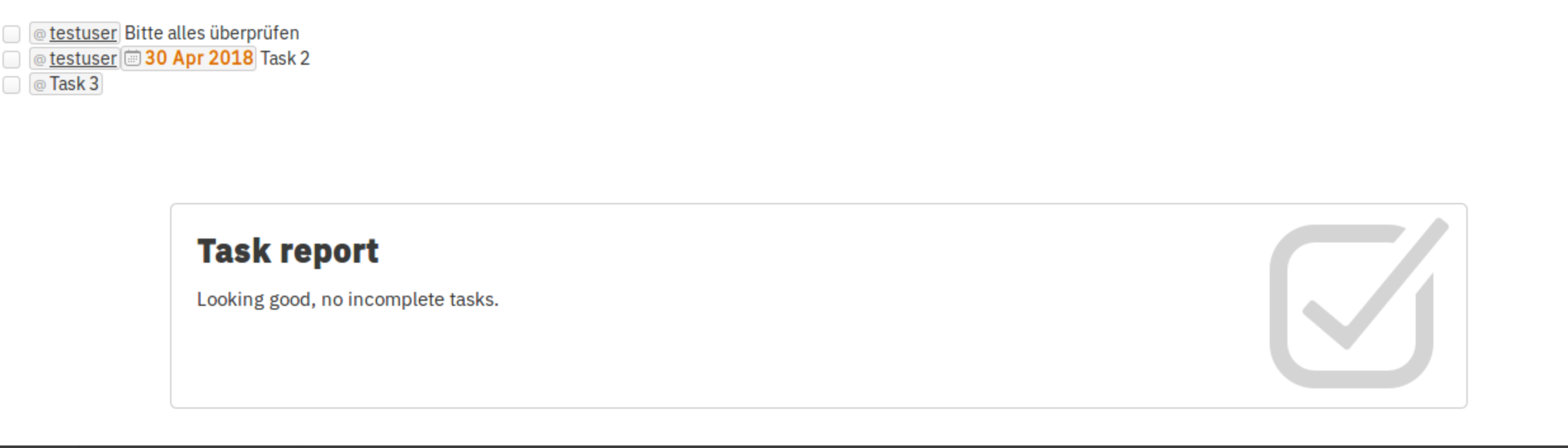

Task report macro not rendering tasks list, on some spaces although you have task list of incomplete tasks .

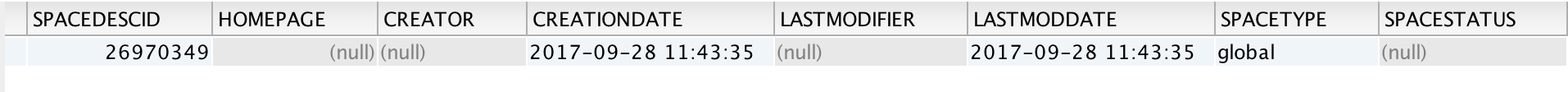

First check the problematic space by running below query, make sure that returning SPACESTATUS column value is NULL
select * from SPACES where SPACEKEY = 'test';

Check the problematic space by running below query, make sure that returning SPACESTATUS column value is NULL
select * from SPACES where SPACEKEY = 'test';Before running the UPDATE: Confirm the space is genuinely intended to be active. A
NULLSPACESTATUS value (which this article addresses) is an anomalous state — distinct from'ARCHIVED', which indicates a deliberate archival. If the diagnostic query in Step 2 returnedSPACESTATUS = 'ARCHIVED'instead ofNULL, the space was intentionally archived and should not be reactivated without confirming with the space owner. Only proceed with the UPDATE if SPACESTATUS is confirmed asNULL.Take a note of the spaceid from the previous query and use it to update spacestatus to 'CURRENT' status
update spaces set spacestatus = 'CURRENT' where spaceid = '98306' ;Start Confluence
Validate that the task report macro is working properly now
Verify the change is reflected in the UI:
Navigate to the affected space and confirm it loads normally — there should be no "Archived" banner displayed.
Open the Space Directory (☰ > Spaces > Space directory) and confirm the affected space appears in the default list (archived spaces are hidden by default).
Confirm the Task Report Macro on the page now renders the expected task list.
If the space still appears archived or the macro does not render, re-check the SPACESTATUS value in the database and confirm Confluence was fully restarted (all nodes in a Data Center cluster).
