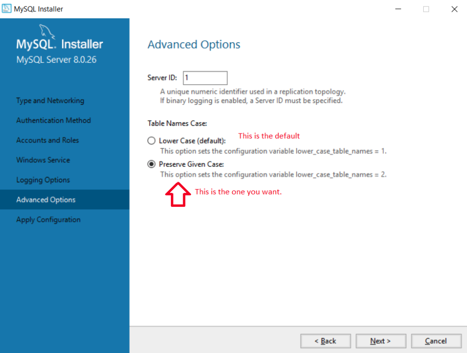

    Windows Setting
    The lower_case_table_names setting can't be changed on a Windows server once it is installed.

How table and database names are stored on disk and used in MySQL is affected by the lower_case_table_names system variable, which you can set when starting mysqld. lower_case_table_names can take the values shown in the following table. This variable does not affect case sensitivity of trigger identifiers. On Unix, the default value of lower_case_table_names is 0. On Windows, the default value is 1. On macOS, the default value is 2.
Value
Meaning
0
Table and database names are stored on disk using the lettercase specified in the CREATE TABLE or CREATE DATABASE statement. Name comparisons are case-sensitive. You should not set this variable to 0 if you are running MySQL on a system that has case-insensitive file names (such as Windows or macOS). If you force this variable to 0 with --lower-case-table-names=0 on a case-insensitive file system and access MyISAM tablenames using different lettercases, index corruption may result.
1
Table names are stored in lowercase on disk and name comparisons are not case-sensitive. MySQL converts all table names to lowercase on storage and lookup. This behavior also applies to database names and table aliases.
2
Table and database names are stored on disk using the lettercase specified in the CREATE TABLE or CREATE DATABASE statement, but MySQL converts them to lowercase on lookup. Name comparisons are not case-sensitive. This works only on file systems that are not case-sensitive! InnoDB table names and view names are stored in lowercase, as for lower_case_table_names=1.
