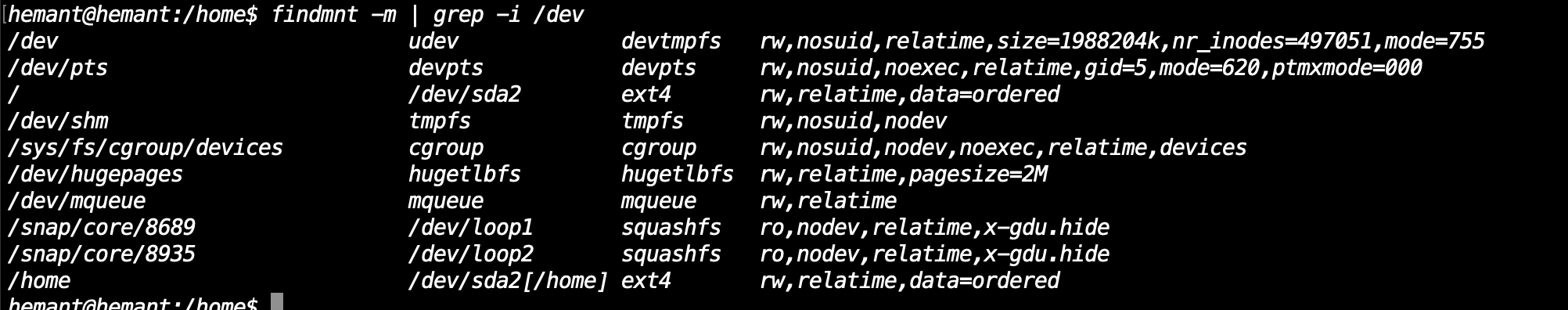

  • Install Confluence for ex: 7.x in the Linux OS where Confluence home is in /home and Confluence install is in /dev .

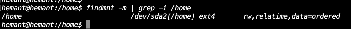

  • Mount /home to exec permission using below command and check the permission after that
$ mount --bind /home /home $ mount -o remount,exec /home
  • With this Configuration, Synchrony get started properly

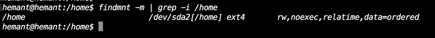

  • Now let’s Change /home to noexec using below command, Stop Confluence and execute below command,
$ mount -o remount,noexec /home
  • After this change, restart the Confluence,
  • Confluence started but Synchrony failed to start with below error,
2020-04-04 18:13:12,561 ERROR [StartEventPublisher:thread-1] [hardware.platform.linux.LinuxGlobalMemory] <init> Failed to get mem_unit from sysinfo. {} java.lang.UnsatisfiedLinkError: /home/hemant/.cache/JNA/temp/jna40762817292981485.tmp: /home/hemant/.cache/JNA/temp/jna40762817292981485.tmp: failed to map segment from shared object at java.lang.ClassLoader$NativeLibrary.load(Native Method) at java.lang.ClassLoader.loadLibrary0(ClassLoader.java:1946) at java.lang.ClassLoader.loadLibrary(ClassLoader.java:1828) at java.lang.Runtime.load0(Runtime.java:810) at java.lang.System.load(System.java:1088) at com.sun.jna.Native.loadNativeDispatchLibraryFromClasspath(Native.java:1018) at com.sun.jna.Native.loadNativeDispatchLibrary(Native.java:988) at com.sun.jna.Native.<clinit>(Native.java:195) at com.sun.jna.NativeLong.<clinit>(NativeLong.java:35) at com.sun.jna.platform.linux.LibC$Sysinfo.<clinit>(LibC.java:48) 2020-04-04 18:14:59,078 ERROR [Long running task: EnableTask] [confluence.util.longrunning.ConfluenceAbstractLongRunningTask] run Long running task "EnableTask" failed to run. -- url: /rest/synchrony-interop/enable | referer: http://192.168.1.8:8090/admin/confluence-collaborative-editor-plugin/configure.action | traceId: 80bbe0e1a4d102dd | userName: admin java.lang.NoClassDefFoundError: Could not initialize class oshi.jna.platform.linux.Libc at oshi.software.os.linux.LinuxOperatingSystem.getProcessId(LinuxOperatingSystem.java:344) at com.atlassian.confluence.plugins.synchrony.bootstrap.DefaultSynchronyProcessManager.getConfluenceProcessId(DefaultSynchronyProcessManager.java:702) at com.atlassian.confluence.plugins.synchrony.bootstrap.DefaultSynchronyProcessManager.setupEnvironment(DefaultSynchronyProcessManager.java:391) at com.atlassian.confluence.plugins.synchrony.bootstrap.DefaultSynchronyProcessManager.trySetup(DefaultSynchronyProcessManager.java:709) at com.atlassian.confluence.plugins.synchrony.bootstrap.DefaultSynchronyProcessManager.lambda$startProcess$1(DefaultSynchronyProcessManager.java:603) 2020-04-04 18:16:07,990 ERROR [diagnostics-os-thread] [hardware.platform.linux.LinuxGlobalMemory] <init> Failed to get mem_unit from sysinfo. {} java.lang.NoClassDefFoundError: Could not initialize class com.sun.jna.platform.linux.LibC$Sysinfo at oshi.hardware.platform.linux.LinuxGlobalMemory.<init>(LinuxGlobalMemory.java:62) at oshi.hardware.platform.linux.LinuxHardwareAbstractionLayer.getMemory(LinuxHardwareAbstractionLayer.java:59) at com.atlassian.confluence.internal.diagnostics.OperatingSystemMonitor.getAvailableMemory(OperatingSystemMonitor.java:211) at com.atlassian.confluence.internal.diagnostics.OperatingSystemMonitor.checkFreeMemory(OperatingSystemMonitor.java:158) at com.atlassian.confluence.internal.diagnostics.OperatingSystemMonitor.lambda$startMonitorThread$1(OperatingSystemMonitor.java:122) at java.lang.Thread.run(Thread.java:748)

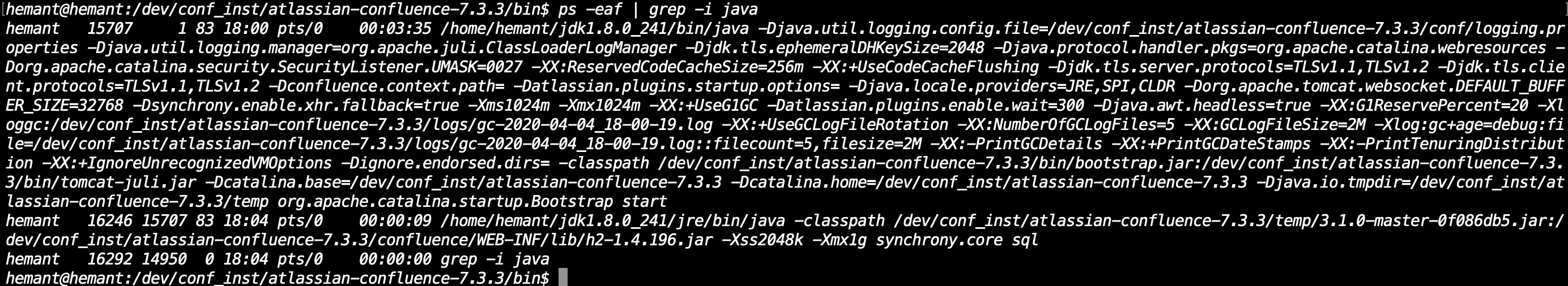

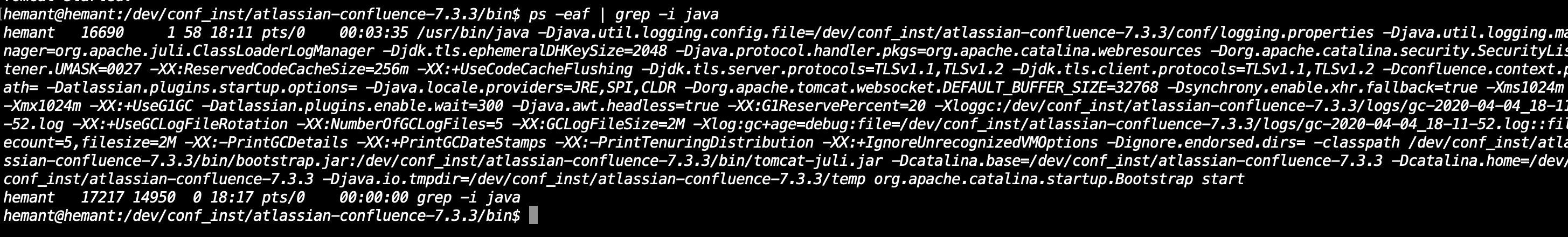

  3. Or, change the JNA temp dir with the following system property:
-Djna.tmpdir=<path>
