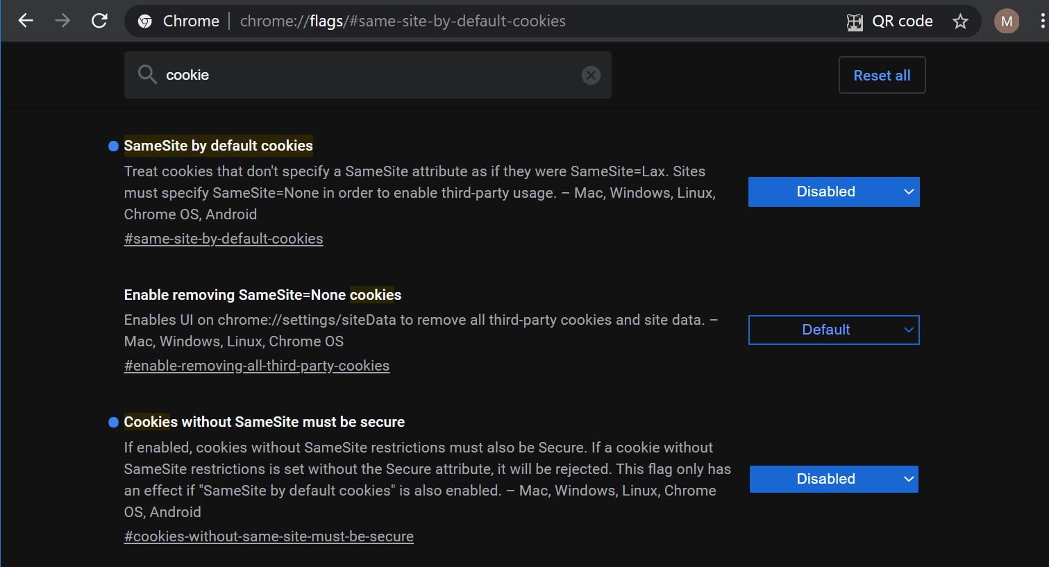

For Chrome release 80 or later, till version 90
In order to determine if this is the issue, a user can load chrome://flags and set the three SameSite flags to the following values:
