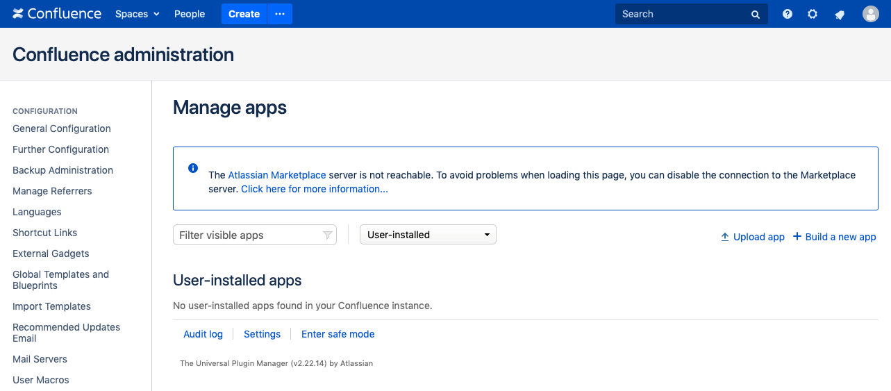

Confluence is unable to connect to the Atlassian Marketplace, and the logs show the following error:
1 WARN [UpmScheduler:thread-1] [atlassian.upm.pac.PacClientImpl] get Error when querying application info from MPAC: com.atlassian.marketplace.client.MpacException: javax.net.ssl.SSLHandshakeException: sun.security.validator.ValidatorException: PKIX path building failed: sun.security.provider.certpath.SunCertPathBuilderException: unable to find valid certification path to requested target
When viewing the Manage Apps page, you see the following:
