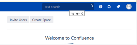

Confluence 6.14 and higher versions were shipped with a new, expanded search panel.
However, attempting to search in Firefox and Internet Explorer does not seem to work.
Hovering the search bar will give (g, gor /), and entering text will trigger the infinite spinning wheels
