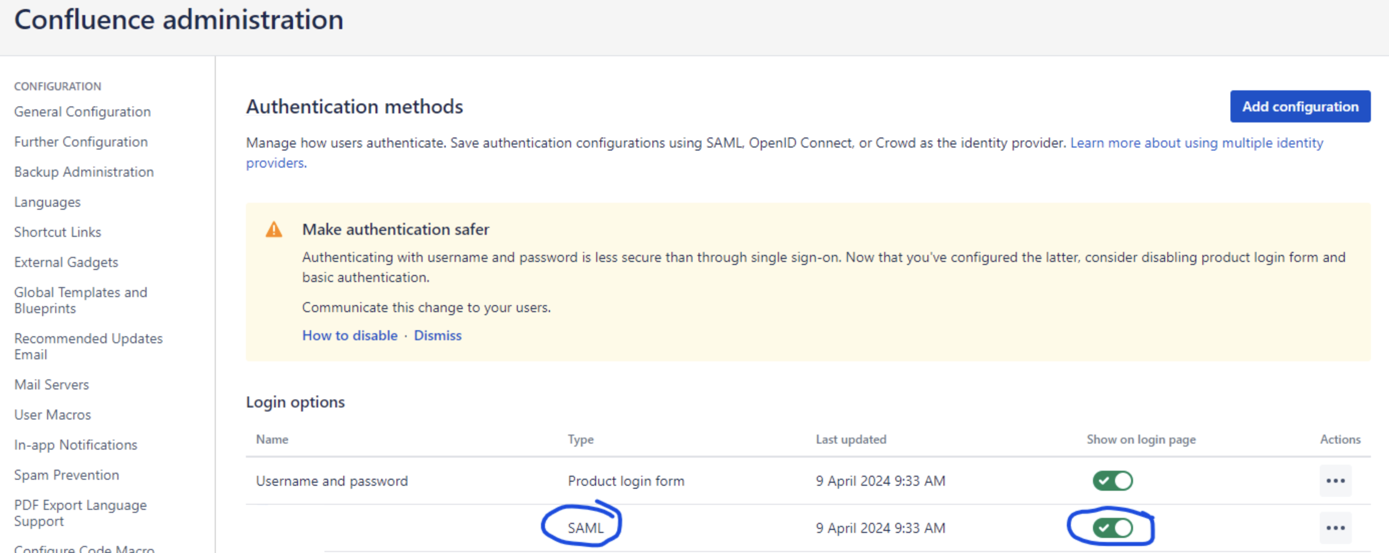

The SAML Authentication Login button doesn't appear as expected on the Confluence Login page when using multiple Idp as described in our documentation Using Multiple Identity Providers.

  1. You are using two or more login authentication types, including Basic Authentication.
2. You have the following in the logs after the most recent startup.
[confluence.admin.actions.SystemInfoOnStartup] startup Datlassian.recovery.password=
Cause
This can occur when you are using multiple login methods. For example when using both your Idp (identity provider) and Basic Authentication login methods simultaneously. It is possible to configure a custom login button that will redirect an unauthenticated user to the Idp login form, and this custom button will be displayed on the login page.
When only one SAML login method is configured, users will be automatically redirected to that method for authentication. If you enable more than one authentication method, the expected behavior would be that your users will see a login page with the available options. In this case, with basic and SAML configured and its authentication login enabled, the Login button doesn't appear on the Confluence Login page, even with "Show on Login page" checked. No errors appear in the UI.
ℹ️ Note from the multiple IdP providers page, that the following is advised but not required: "Once you've added a single sign-on configuration method to your environment, we advise you to disable the basic authentication option, which is less secure. See Disabling basic authentication."
Recovery mode is still enabled. As stated in Restore Passwords to Recover Admin User Rights (mentioned in "Good to know" at the bottom), it must be disabled for SAML authentication to work properly.

Disable Recovery mode per the instructions found in Restore Passwords To Recover Admin User Rights.
