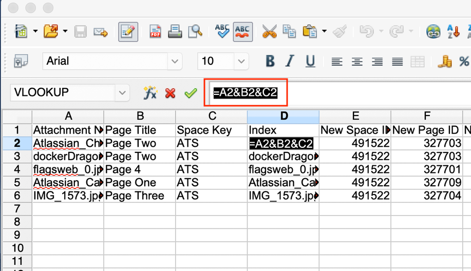

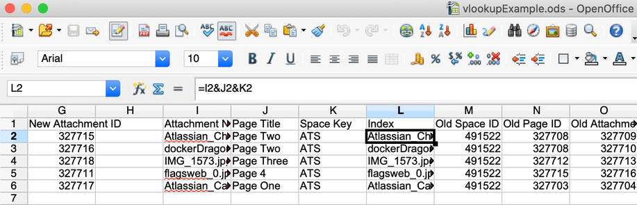

Now insert a column between the Space Key and Space ID columns in each result set for the correlation index. To create the index you can just use the concatenation operator (ie. '=A2&B2&C2') in the formula bar like this:
FInally, you should have two index columns (one in the new result set and one in the old result set) with a string in it that is a combination of the attachment name, page title, and space key.
You will want to copy the index from the first row and paste it into every additional row so this value exists for all rows in the spreadsheet (you will need to do this for for the old result set and the new result set).

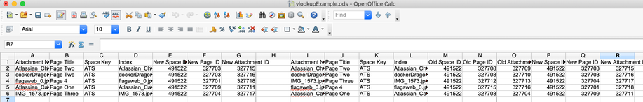

At this point your spreadsheet should look similar to this example:

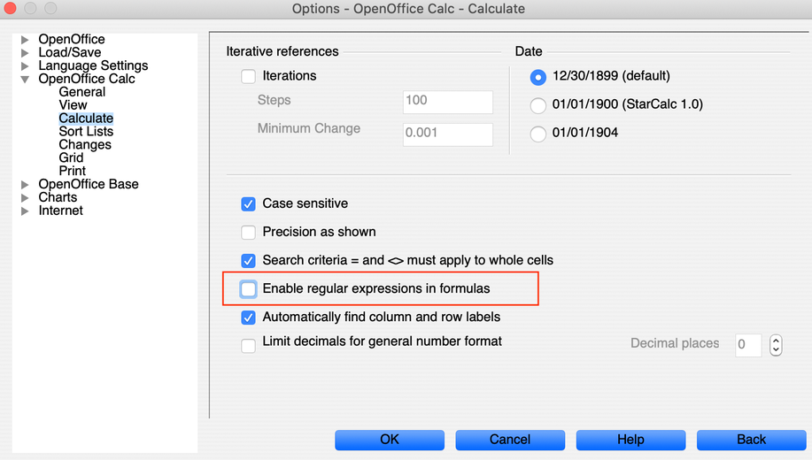

To do this we will use the VLOOKUP function. For example, If you are using OpenOffice Calc, make sure you go into the OpenOffice menu > OpenOffice Calc > Calculate and then uncheck the ‘enable regular expressions in formulas’ option. This option is enabled by default, and leaving it enabled can interfere with the VLOOKUP results:

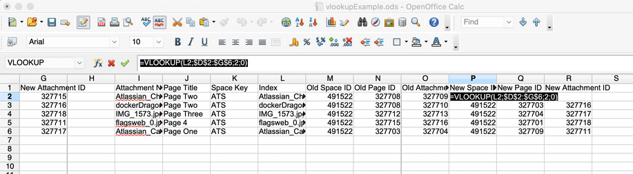

The first thing you will want to do is add 3 new columns right after the old attachment id column. Please make sure you use the same header names (New Space ID, New Page ID, New Attachment ID). Once that’s done you will want to use a VLOOKUP formula to correlate the ids such as this one:
1 =VLOOKUP(L2;$D$2:$G$6;2;0)
Here is an example:
This VLOOKUP formula basically tells OpenOffice CALC to match the value in L2 to the corresponding value in the range of D2 and G6, which is where we put the new IDs. Since we created the index, and since an attachment with the same name should not exist in the same page in the same space, this should correlate everything accurately.
VLOOKUP basically takes 4 arguments, separated by a ; (this would be a comma in Excel). x also added a $ before each letter and number in the target range so that these cell letters and numbers are frozen and we can quickly and easily copy and paste this cell into the cells below it to populate the rest of the rows in each column. The 2 in the second to last field in the VLOOKUP tells us to return the value in column 2 of the range we are comparing, and you will pretty much always want to add 0 (or false) for the last field.

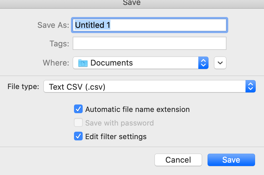

Now we want to review our results in this sheet and remove any "N/A' values so we only have IDs in every cell of the new sheet. This is very important since the python script will not work if any of the values in the new sheet are not integers. Now save the new sheet as a CSV file. To do this just hit file, save as and then choose Text CSV (.csv) for the file type. You will also want to make sure you check the ‘Edit filter settings’ option on the save screen.

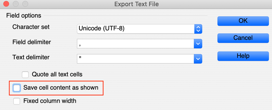

If you are using OpenOffice CALC you need to uncheck the ‘Save cell content as shown’ option on the next screen, which is also enabled by default:
Having this enabled can cause issues when the python CSV library that we are going to use tries to parse the CSV file, so please make sure you remember to disable this option.

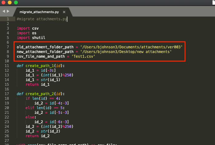

Once the CSV file is created we just need to open the python script and specify the location for the old attachments folder, the location where we will create the new attachments folder, and the CSV file name and path:
In this example we kept the CSV file in the same directory as the python script. Please note the new attachments folder can be any folder anywhere on disk. It just needs to be empty and have enough disk space available for the attachment that are being copied. Once this is done we just run the script with python3. The script may take some time to run depending on how many attachments there are, and here’s what the output should look like once it's finished:

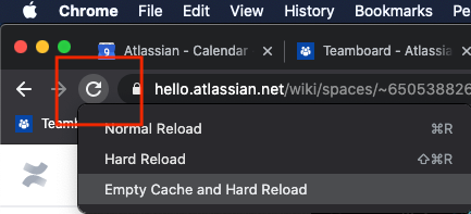

Step 7 - Asking End Users to Refresh Their Browser Cache
Some end users may need to perform a hard refresh in their browser to see the attachments in Confluence. In chrome you can do this by opening developer tools, then right clicking the refresh button in the upper left part of the screen and hitting Empty Cache and Hard Reload:
