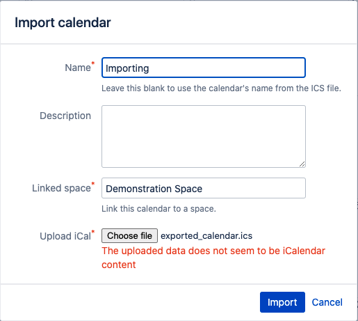

When attempting to import an ics/ical calendar into Team Calendars, import is failing with the following warning:
1
The uploaded data does not seem to be iCalendar content
