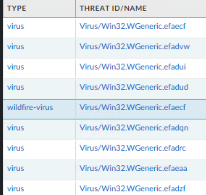

On further investigation, we have observed there is a difference in the File which is getting downloaded on the Customer instance,
  • Original file from Plugin vendor drawio-confluence-plugin-12.4.0.obr = 43Mb
  • User instance downloaded: drawio-confluence-plugin-12.4.0.obr = ~15Mb
It is observed that the issue is within the Customer configured network firewall (from Paloalto), as even if we shared the file by renaming or some other source location, it is still downloading the ~15Mb file (shows 100% download)
On further investigation, the "drawio-confluence-plugin-12.4.0.obr" containing the signature seems to be blocked by the Palo Alto network firewall, hence restricting downloading the complete files. Warning observed at network firewall while downloading the installation drawio-confluence-plugin-12.4.0.obr file.
Solution
Solution/Workaround
  1. As a workaround, you can use the lower version obr file ( Plugin version lower than 12.4.0), installation works as expected.
  2. To mitigate the issue, Request the "Palo Alto" network team to add the exception into the firewall rule for the blocked signatures. As the draw.io team confirmed, it is a false alarm from the network; the file is completely secured.
  3. Paul Alto Team has confirmed that, "After further review, we have determined the samples the signature was built for to be a false positive and have disabled the signatures (all 16 signature Threat ID's). This will already be updated in Wildfire and in AV in a day"
