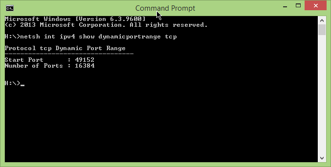

  • To check the total number of allowed ephemeral ports via command line:
    netsh int ipv4 show dynamicportrange tcp
    • Example Result showing 16384 total available ephemeral ports:
    • (Auto-migrated image: description temporarily unavailable)
