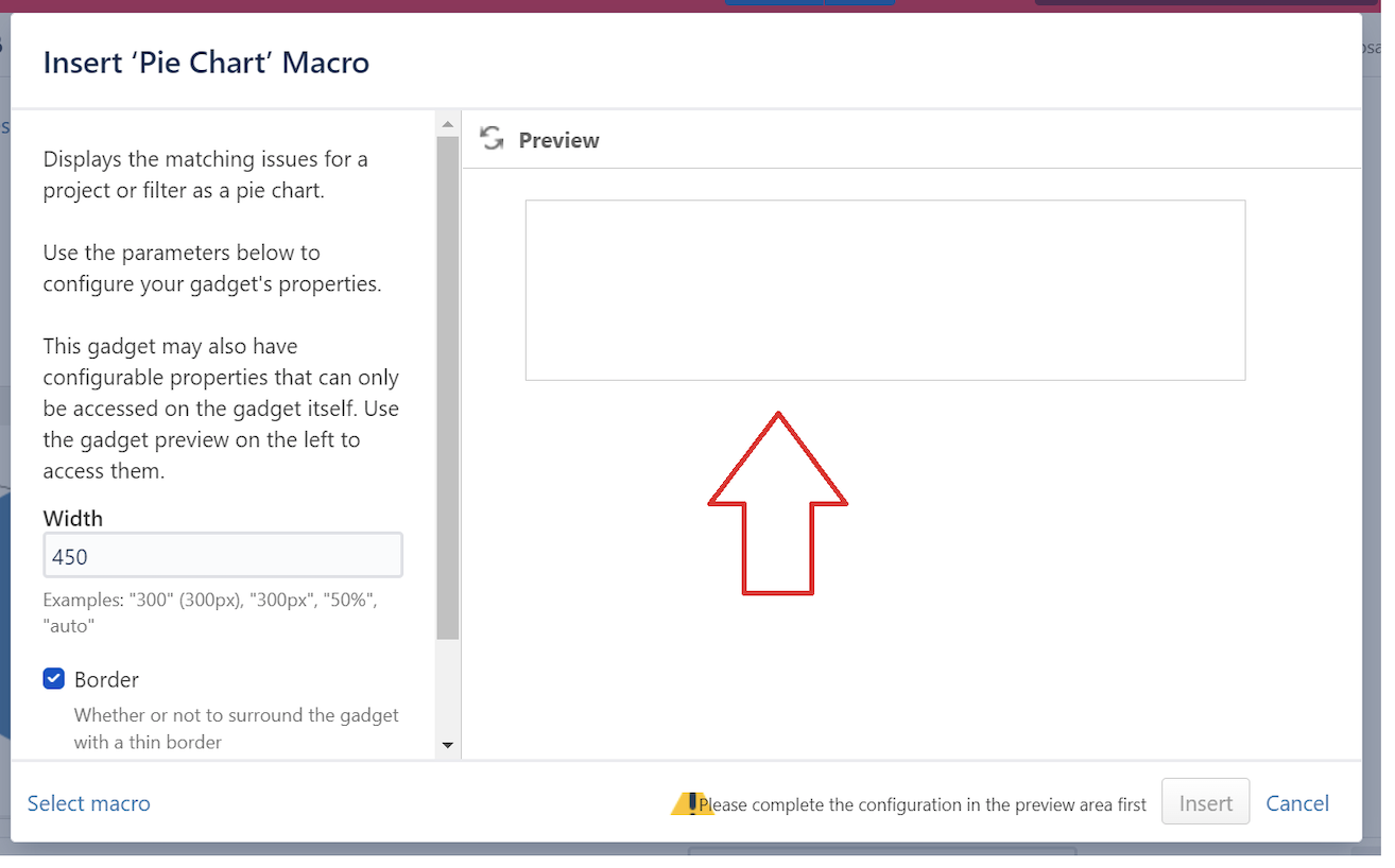

Jira gadgets stop working and can throw errors such as HTTP 500 Internal Server Errors. URLs are pointing to the old Jira Base URL.
Diagnostics
The following appears in the atlassian-confluence.log:
Error rendering macro 'gadget' : The gadget at https://<OLD_URL>/rest/gadgets/1.0/g/com.atlassian.jira.gadgets:filter-results-gadget/gadgets/filter-results-gadget.xml was not added to this Confluence instance yet. . OR . Unhandled exception occurred whilst decorating page -- url: /plugins/servlet/gadgets/makeRequest | userName: sysadmin | referer: http://Confluence_URL/plugins/servlet/gadgets/ifr?container=atlassian&mid=xxxxxxxxxxxxxxxxxxxxxxxxxxxxxxxxxxxxxxxxxxxxxxxxxxxxxxxxxxxxxxxxxchart%2Fgadgets%2Fgreenhopper-hour-burndown-chart.xml&libs=auth-refresh java.lang.NullPointerException at com.atlassian.gadgets.renderer.internal.http.TrustedAppContentFetcherFactory.createCertificate(TrustedAppContentFetcherFactory.java:70) at com.atlassian.gadgets.renderer.internal.http.TrustedAppContentFetcherFactory.addTrustedAppHeaders(TrustedAppContentFetcherFactory.java:52) at com.atlassian.gadgets.renderer.internal.http.TrustedAppContentFetcherFactory.fetch(TrustedAppContentFetcherFactory.java:46) at org.apache.shindig.gadgets.servlet.MakeRequestHandler.fetch(MakeRequestHandler.java:84)

After moving the instances from the Atlassian Cloud to an Atlassian DC environment, the application links continue to make a reference to the CLOUD application link URL, and the gadgets stop working correctly due to corruption on the KEYSTORE table.

⚠️ Please note this issue is also observed when moving instances from one Atlassian DC to another. The gadgets window appears blank, along with the same errors seen in atlassian-confluence.log as documented above.
