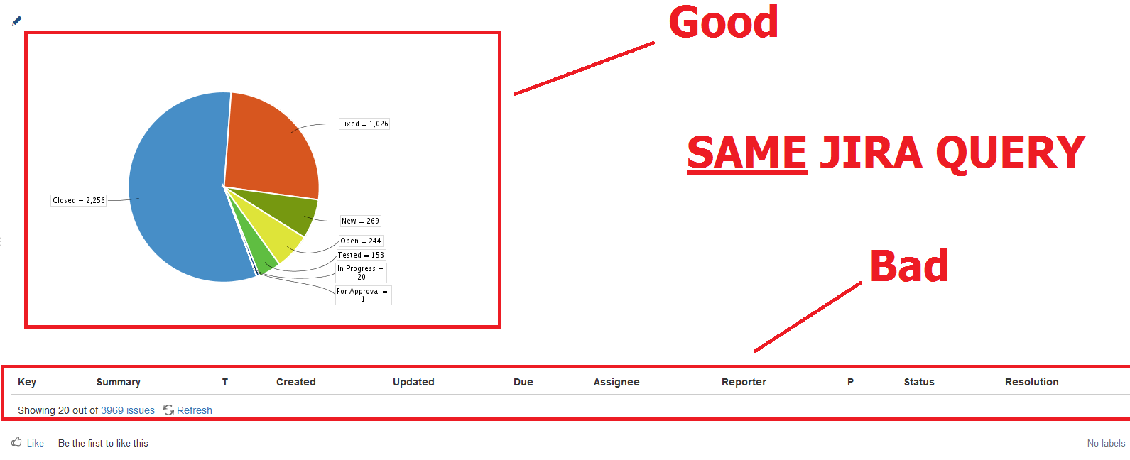

JIRA Issues Macro only shows the total amount of issues in JIRA based on the JQL query but not listing the specific issues even after the "Table" option is chosen.
In some cases, a NullPointerException may be seen instead of the empty table.
Diagnosis
  • Using the same JQL query for Charts macros works fine
  • Using the same JQL query for JIRA Issue macro only shows the total amount of issues
