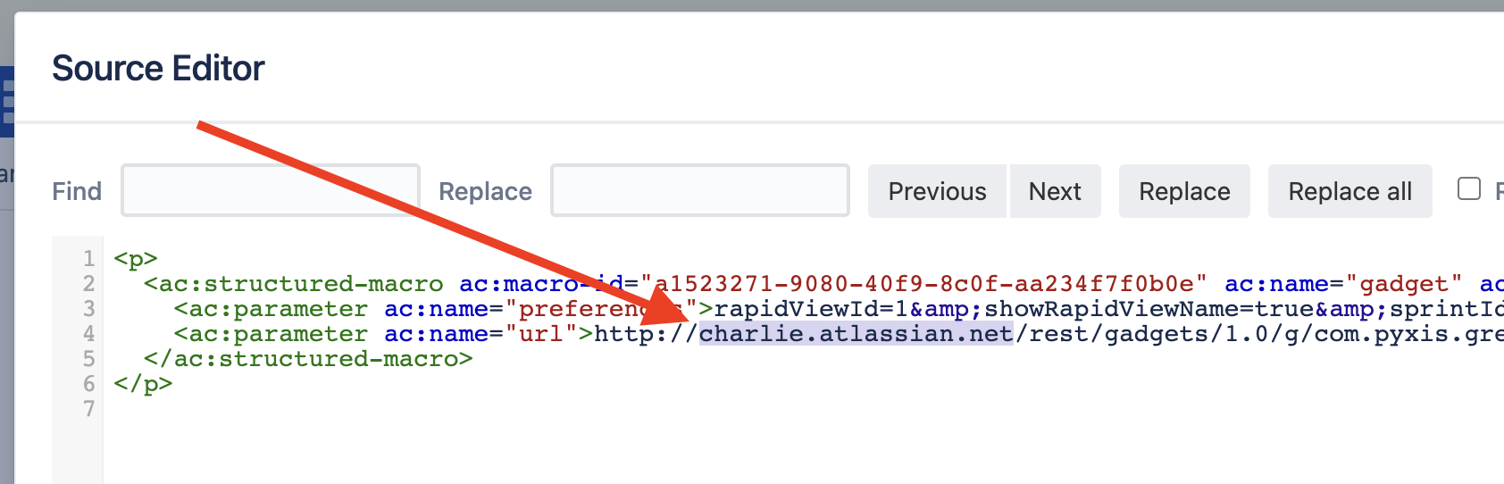

Navigate to the affected page and select Edit at the top of the page.
Select the Open in source editor button ('<>' symbol in the upper-right corner).
Locate the <ac:parameter ac:name="url"> parameter.
Replace the invalid URL with the correct one. For the example, we should replace 'charlie.atlassian.net' with a new URL that points to the correct Jira Server/Data Center endpoint.
Click Apply then Update
Refresh the page.
Here's an example of how the Sprint Health Gadget looks in Storage Format:
<p>
<ac:structured-macro ac:macro-id="a1523271-9080-40f9-8c0f-aa234f7f0b0e" ac:name="gadget" ac:schema-version="1">
<ac:parameter ac:name="preferences">rapidViewId=1&showRapidViewName=true&sprintId=1&showSprintName=true&showAssignees=false&isConfigured=true&refresh=15&=false</ac:parameter>
<ac:parameter ac:name="url">http://charlie.atlassian.net/rest/gadgets/1.0/g/com.pyxis.greenhopper.jira:greenhopper-gadget-sprint-health/gadgets/greenhopper-sprint-health.xml</ac:parameter>
</ac:structured-macro>
</p>
