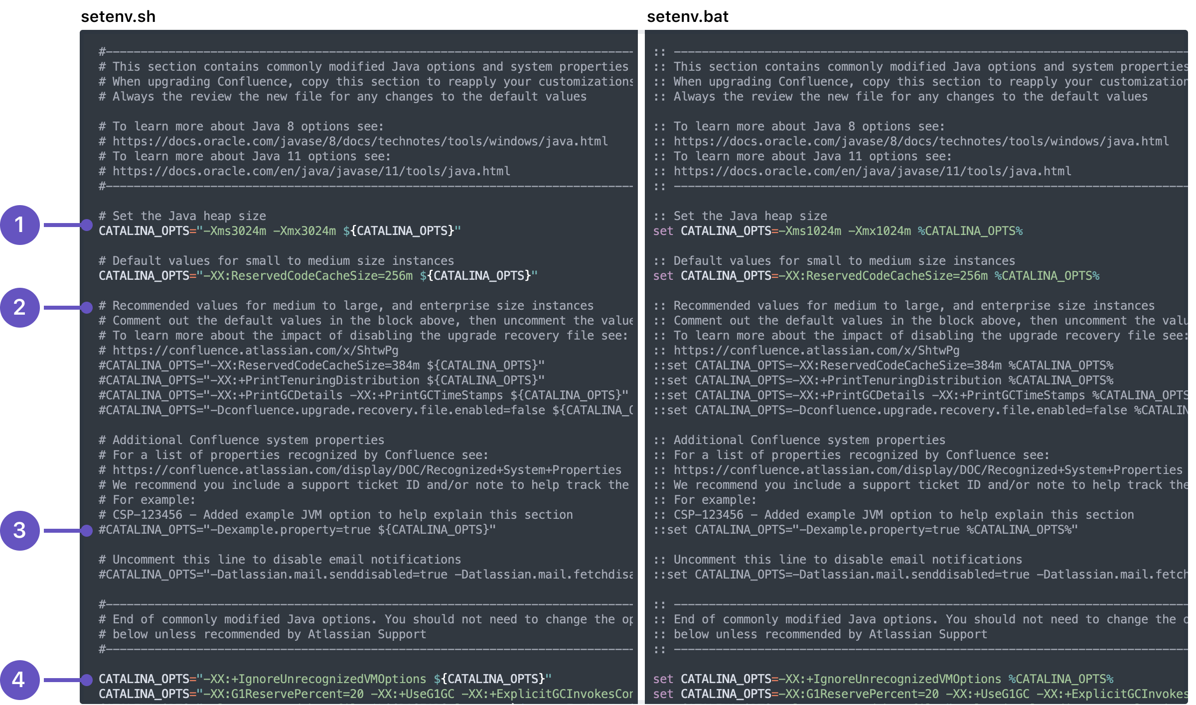

Structure of the setenv file
The new file layout is designed to make it easy for you to manage your customizations, and easily differentiate between your custom properties, and those that are required.
  1. Java heap size - these are the most commonly updated java options.
  2. Recommended properties for large instances - we provide some recommended values for large organisations. If you're a large organisation, you can uncomment these properties, then comment out the properties for small organisations.
  3. Additional Confluence system properties - this is where to put properties specific to your site, so they're easy to see and update. You can also add a comment to indicate why the property has been added, to help admins in the future.
  4. Required properties - these are java options and system properties that you should not change, unless directed to do so by our support team.
Once you've migrated your customizations to the new file format, next time you upgrade, you'll find the process much easier. You'll be able to simply copy over the properties under 'Additional system properties', and change any values of our recommended properties. You won't need to sort through every property to see if it has changed.
