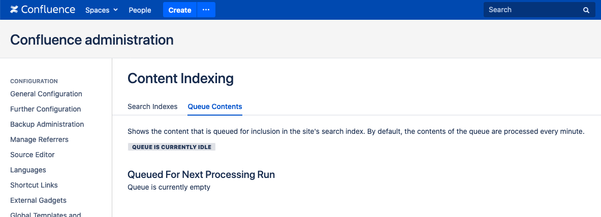

  4. Access the Confluence UI and go to Cog icon > General configuration > Content Indexing > Queue Contents and confirm there’s no item to be processed.
    • If there are items in the index queue, give it a couple of minutes to complete.

  4. Go to Cog icon > General configuration > Content Indexing > Queue Contents and confirm there’s no item to be processed in the indexing queue.

  2. Go to Cog icon > General configuration > Content Indexing > Queue Contents and confirm all objects were processed in index queue.
    • If it is still processing, wait for a minute or so for it to complete.
