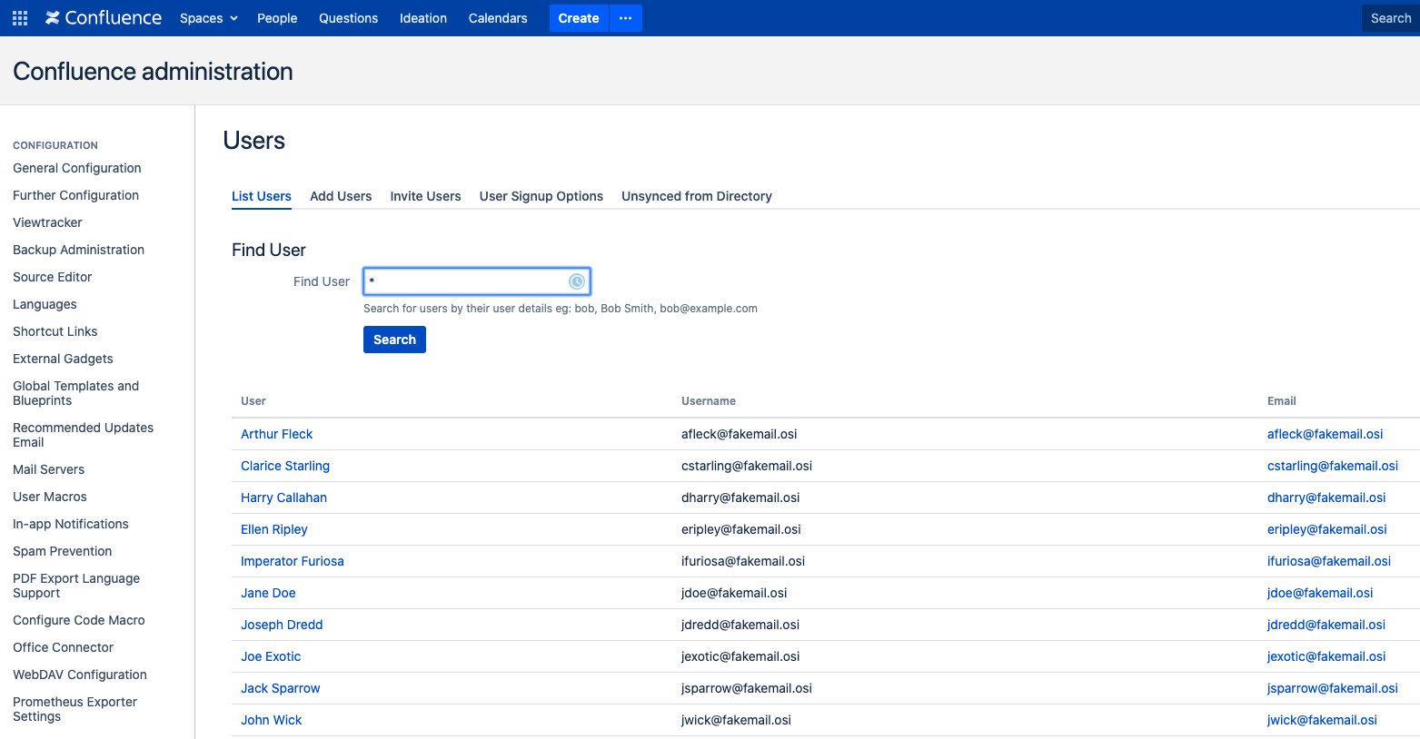

User Base

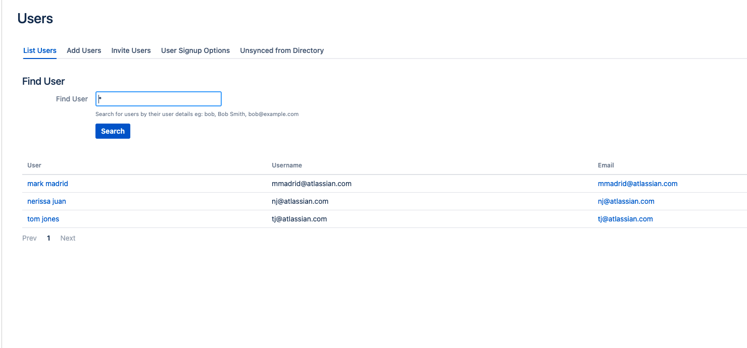

First, we'll need a set of users within Confluence who also exist within OneLogin. These users can be located in any directory whether its an internal, Jira or LDAP directory. In this example, we'll be setting the user's username to their email address.
Screenshot showing the Confluence administration page. The 'Users' page is selected. The page shows a list of Confluence users

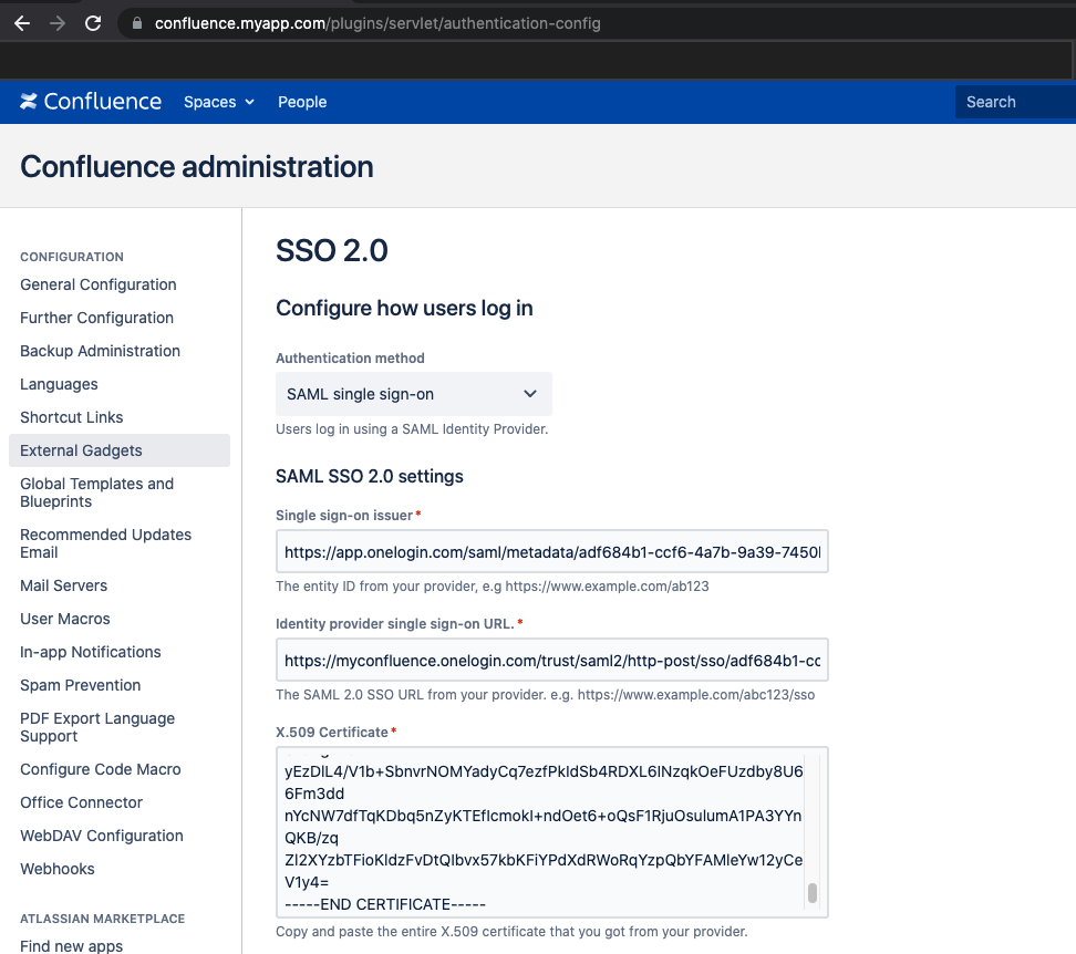

Here's what the completed configuration screens within Confluence should look like:
Screenshot of the Confluence SAML configuration settings. The SAML configuration values have been populated with details from OneLogin
Screenshot showing the Confluence administration page. The current page shows SAML configuration settings - which includes a 'just in time'(JIT) provisioning option that is not selected. There are options for 'SAML SSO 2.0 behavior'

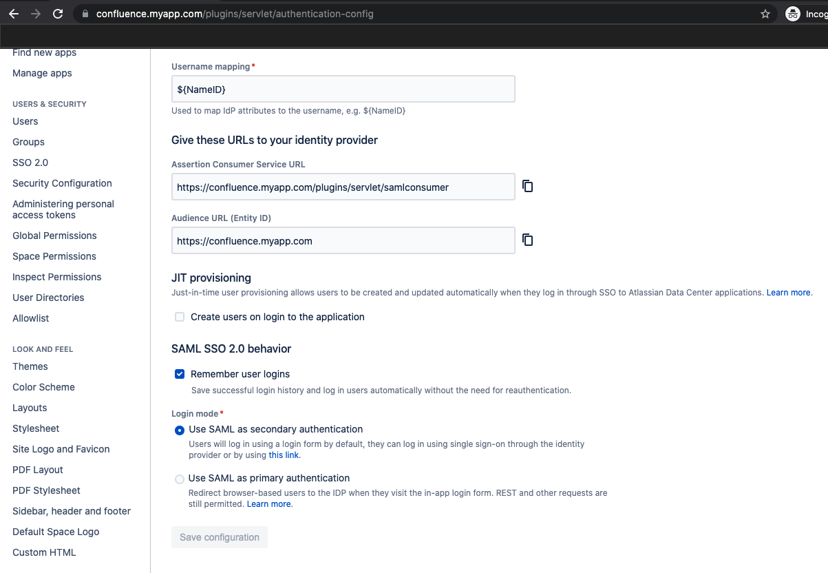

  4. For Username mapping, enter ${NameID}.
  5. Take note of the Assertion Consumer Service URL and Audience URL (Entity ID) values that are generated by Confluence. These will be entered within the OneLogin app configuration.
  6. Check the Remember user logins option.
  7. For Login page settings, you have the option of displaying the IdP on the Login page. It's been checked in this example. We can also add custom text on the Login button. Enter an appropriate value.

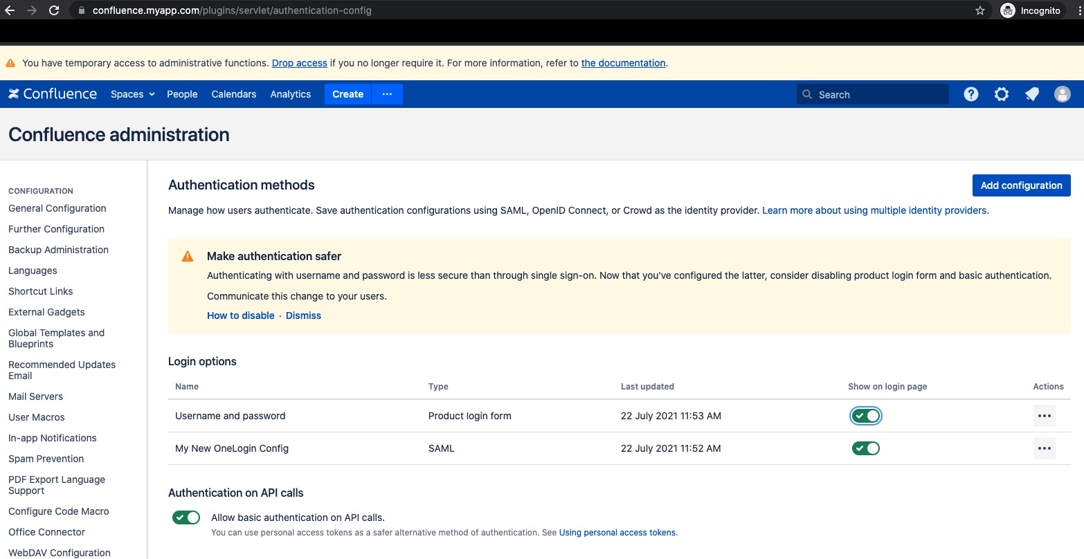

  11. You'll now be directed to a page that provides the option for making the IdP the primary authenticator or the secondary authenticator with the inclusion of a native login form acting as primary. To set the IdP as primary, deselect the Show on login page option for Username and password option. Otherwise to make the native Product login form act as primary and the IdP secondary, leave this toggle selected to the green On position.
    1. When setting this up for the first time, we suggest selecting the Username and password option. With a successful test, then we can switch this over to making the IdP primary. If you do need to bypass SAML, please refer to Enable default login page to bypass SAML in Confluence Data Center.
  12. To test these, click on the '...' link to the right of the appropriate option under the Login options section of the SSO 2.0 page and click Test sign-in.
Here are screenshots showing this setup:
Screenshot showing the SAML configuration values in the Confluence administration page
Screenshot showing the SAML configuration settings in the Confluence administration page
Screenshot of the Confluence administration page which shows the 'Authentication methods' that Confluence offers

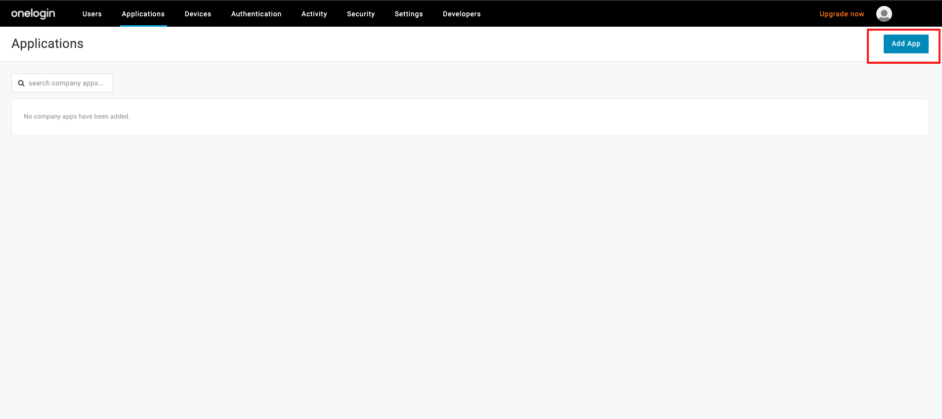

  1. Here, we'll need to create an application. From the OneLogin
    Admin panel, go to Applications > Add App:
    Screenshot showing the 'Add App' button in OneLogin that allows admins to add a new SAML app in OneLogin

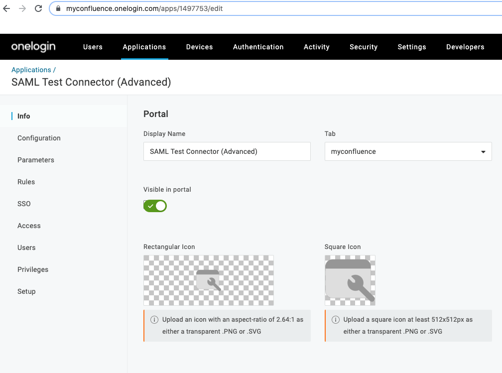

  4. You'll be redirected to a screen like the one below:
    Screenshot showing the 'Info' tab for the SAML app in OneLogin. The page displays the app 'Display Name', 'Visible in portal' toggle and app icons

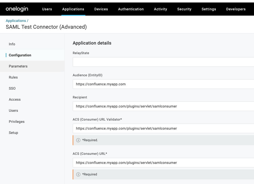

  5. Now, click on the Configuration menu option on the left. On the resulting screen, we'll need to make the following entries:
  6. For the Audience (EntityID) field, copy and enter the Audience URL (Entity ID) value from Confluence. This is the intended audience of the SAML assertion.
  7. For the next three fields, Recipient, ACS (Consumer) URL Validator, and ACS (Consumer) URL, copy and enter the Assertion Consumer Service URL value from Confluence.

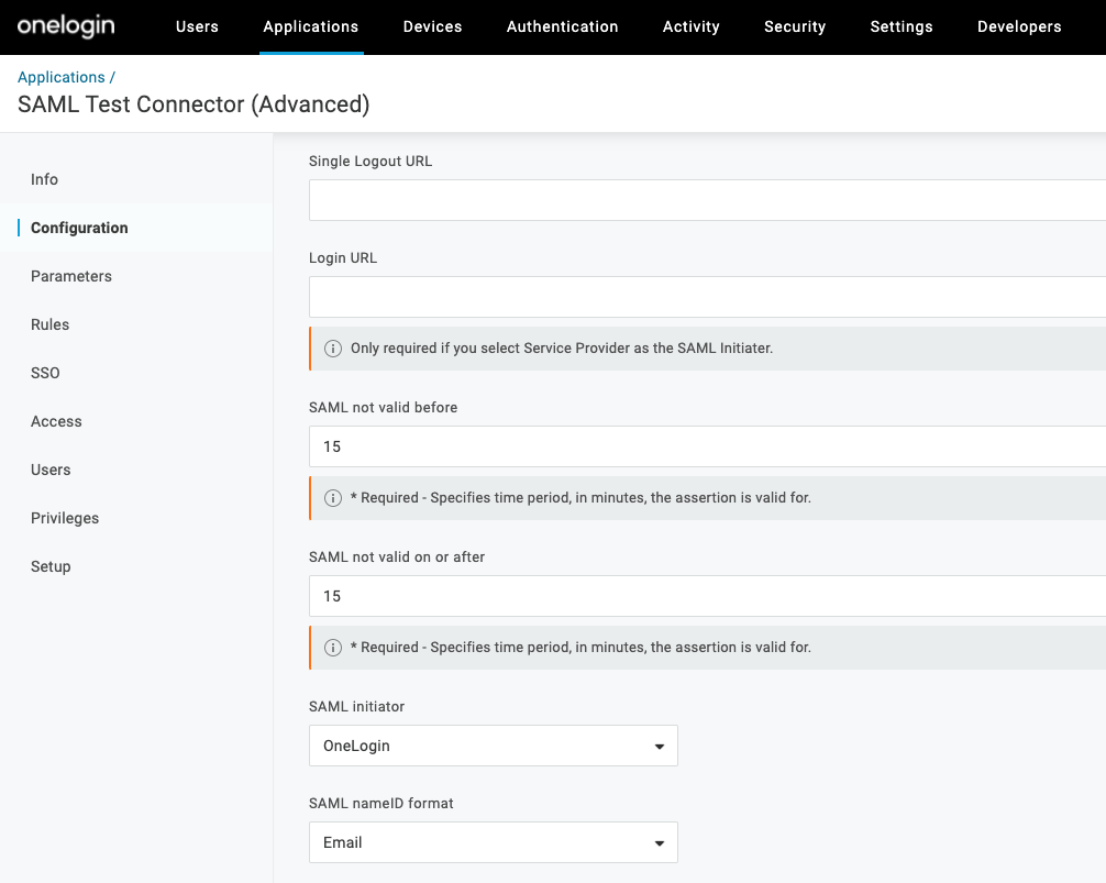

  8. Within the SAML not valid before/after fields, you may need to increase this depending how in sync your workstation or server time is with the OneLogin server time. In my local test environment, I increased this to 15 minutes.
  9. For SAML initiator, select OneLogin.
  10. For SAML nameID format, select Email.

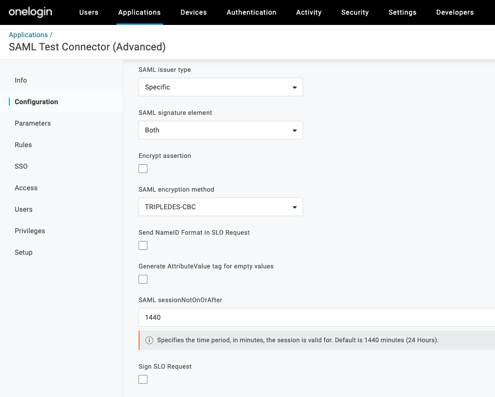

  11. For SAML issuer type, select Specific.
  12. For SAML signature element, select Both.
  13. For SAML encryption method, select TRIPLEDES-CBC.
  14. For SAML sessionNotOnOrAfter, enter 1440.
  15. Click Save.
  16. The completed entry screen should look something like this:
    Screenshot showing the SAML Configuration page in OneLogin. The image shows 'RelayState',  'Audience', 'Recipient' and ACS
    Screenshot showing SAML configuration settings in OneLogin including 'SAML not valid before' and 'SAML not valid on or after' values
    Screenshot from OneLogin showing the SAML configuration settings including 'SAML issuer type', 'SAML signature element', 'SAML encryption method' and 'Encrypt assertion'

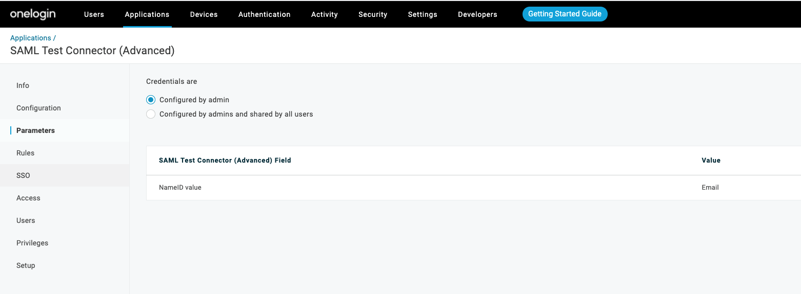

  17. Now, we'll need to ensure that the NameID value is set to Email on the Parameters screen:
    Screenshot. showing the NameID claim for the SAML configuration in OneLogin

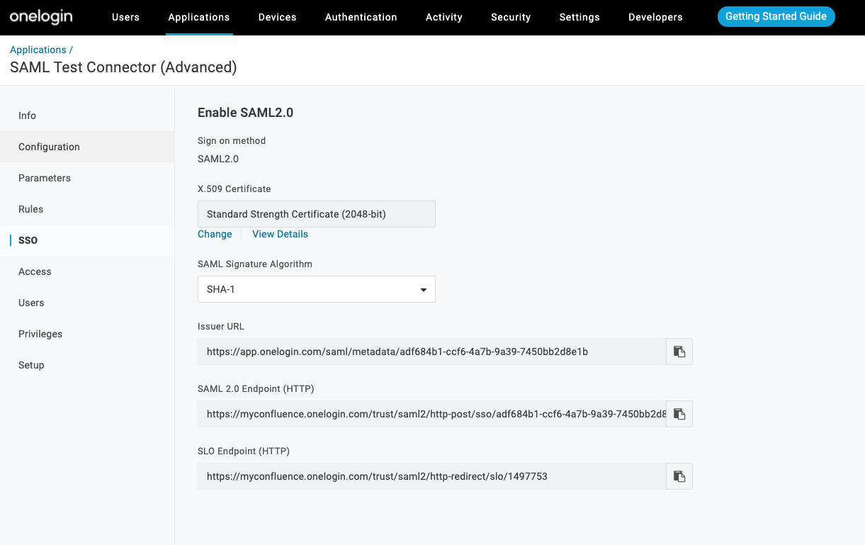

  18. Next, click on the SSO page for several values that we'll now need to copy back to the Confluence SSO 2.0 configuration screen:

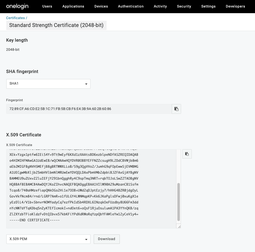

    1. Click the View Details link to get the contents of the X.509 Certificate.
    2. Note the Issuer URL and SAML 2.0 Endpoint (HTTP) values.
      Screenshot showing the OneLogin SO configuration values. There are values for 'Issuer URL' and 'SAML 2.0 Endpoint'
      Screenshot showing the x.509 certificate for the SAML app in OneLogin

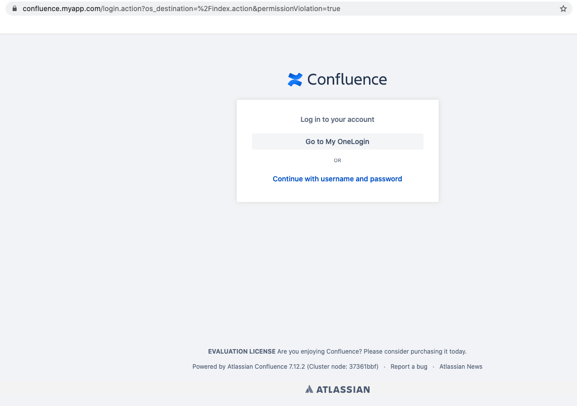

When the IdP is enabled along with the native Product login form
  • If you have a logged in session with OneLogin and access Confluence from there, you should be taken directly to the Confluence home page with a logged in Confluence session.
  • If you access Confluence directly from its base URL:
    • Confluence will display a screen with options to login from OneLogin or to continue with using a username and password:
      Screenshot showing the Confluence login screen. There is a button to 'Go to My OneLogin' and a link to 'Continue with username and password'

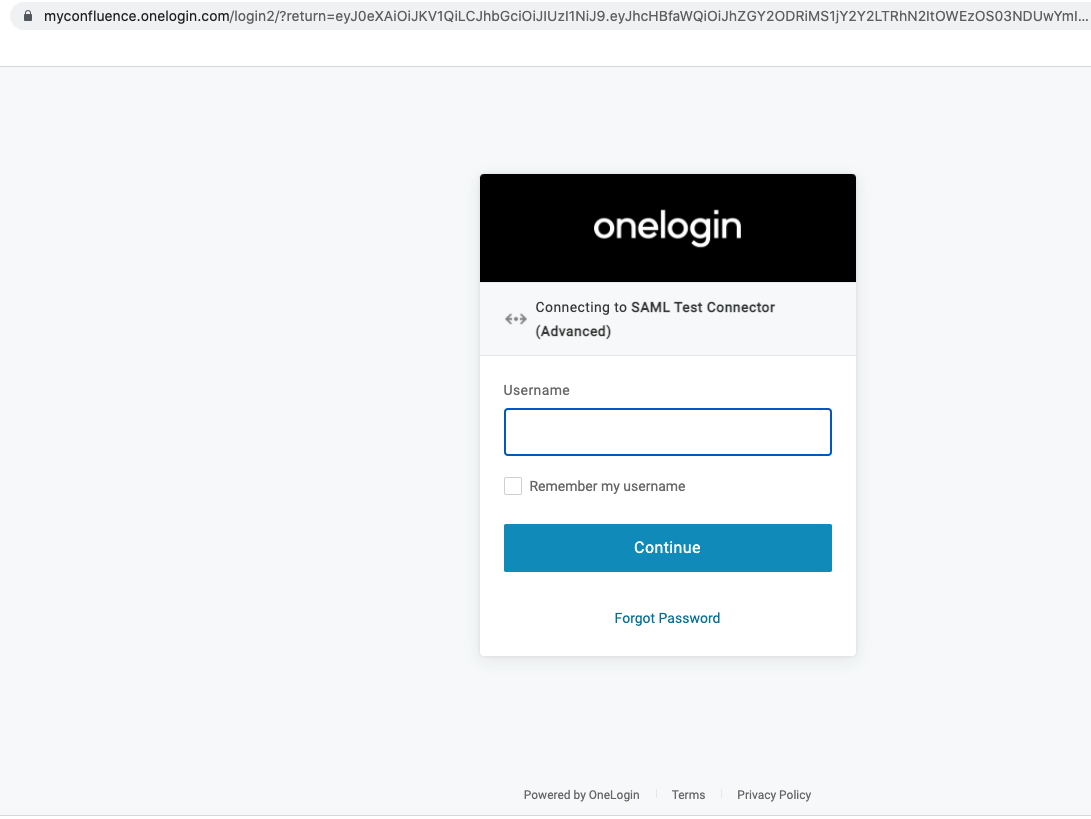

      • Choosing the OneLogin option, Confluence will perform a quick redirect to OneLogin. If you are not logged in with OneLogin, you will need to enter your credentials there. For example:
        Screenshot of OneLogin login screen. There is a username field with a 'Continue' button
      • Once provided or if you already have a logged in session, you should then be redirected to the Confluence home page with a logged in Confluence session.
      • Choosing the username/password option, Confluence will display its native login screen.

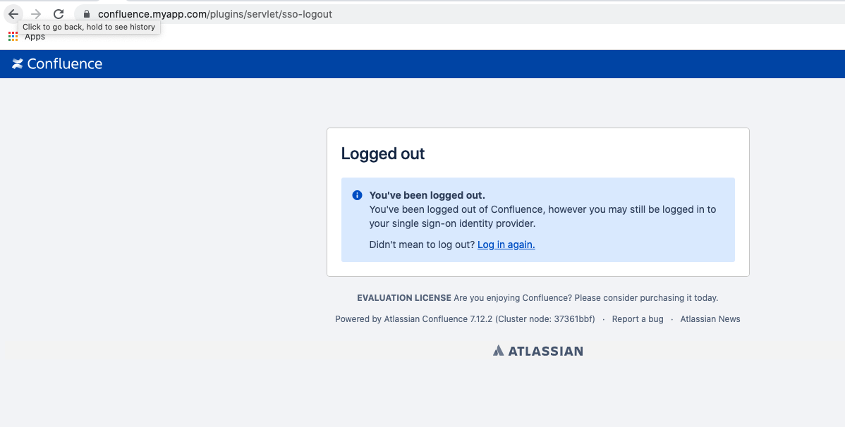

  • When logging out, Confluence will display a screen with a link to log in again:
    Screenshot showing Confluence user being logged out of the Confluence instance.

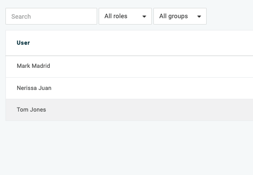

After configuring Confluence SSO 2.0 and OneLogin, testing sign in action failed with stack trace:
2022-01-12 12:08:53,249 ERROR [http-nio-8090-exec-7] [impl.web.filter.ErrorHandlingFilter] logException [UUID: b8cd4812-03f5-4a8c-8364-8c80bde4d22d] Received invalid SAML response: A valid SubjectConfirmation was not found on this Response: SubjectConfirmationData doesn’t match a valid Recipient -- referer: https://atlassian-support-eng-dev.onelogin.com/ | url: /plugins/servlet/samlconsumer | traceId: 9b05bb15b1e6e9b3 | userName: anonymous com.atlassian.plugins.authentication.impl.web.saml.provider.InvalidSamlResponse: Received invalid SAML response: A valid SubjectConfirmation was not found on this Response: SubjectConfirmationData doesn’t match a valid
Cause: user's name doesn't match between Confluence and OneLogin. The name checks are case-sensitive. User's names in Confluence are in lower case, but names are capitalized in OneLogin.
Screenshot showing list of users in OneLogin
Screenshot showing the Confluence Users page. There are a number of users listed with their usernames and email addresses
Fix: Ensure the user's names exactly match, including the letter case.
