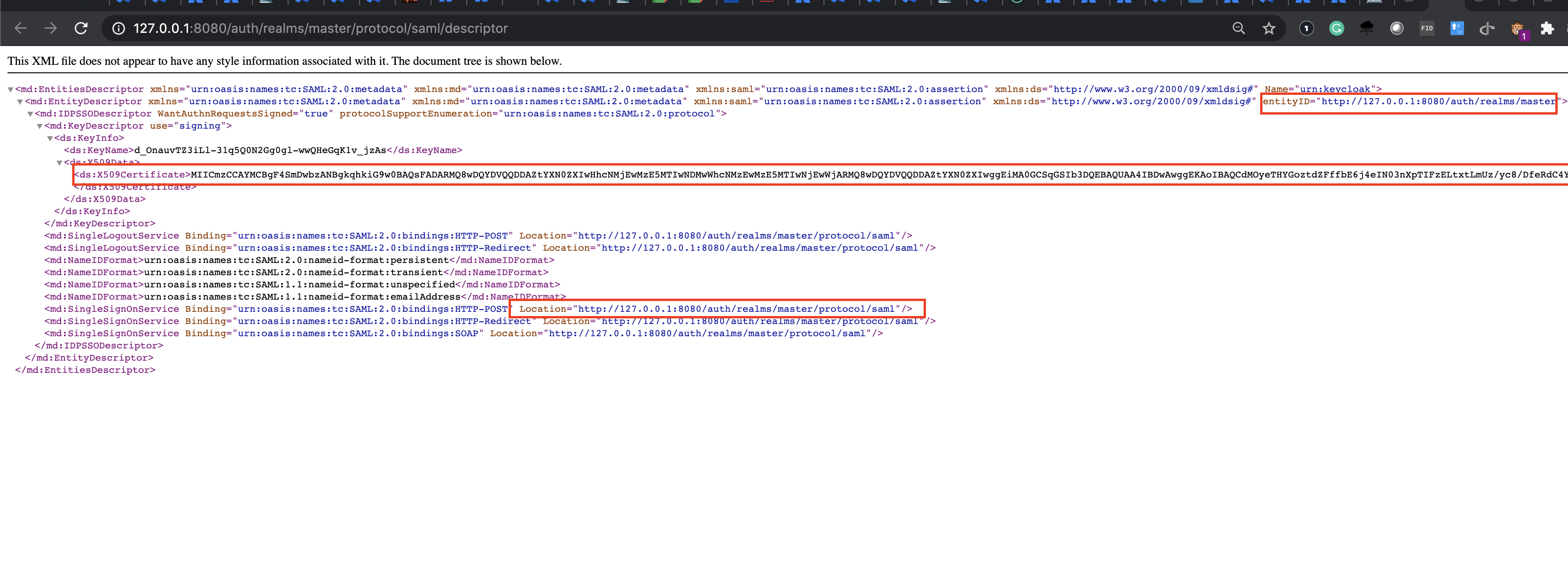

  1. In the Keycloak console, we want to retrieve metadata from our Keycloak instance, which we will use in the Atlassian SAML app. You can get this information by clicking on "SAML 2.0 identity provider metadata".
  2. On the new page http://127.0.0.1:8080/auth/realms/master/protocol/saml/descriptor we will see information about entityID, X509Certificate, and Location

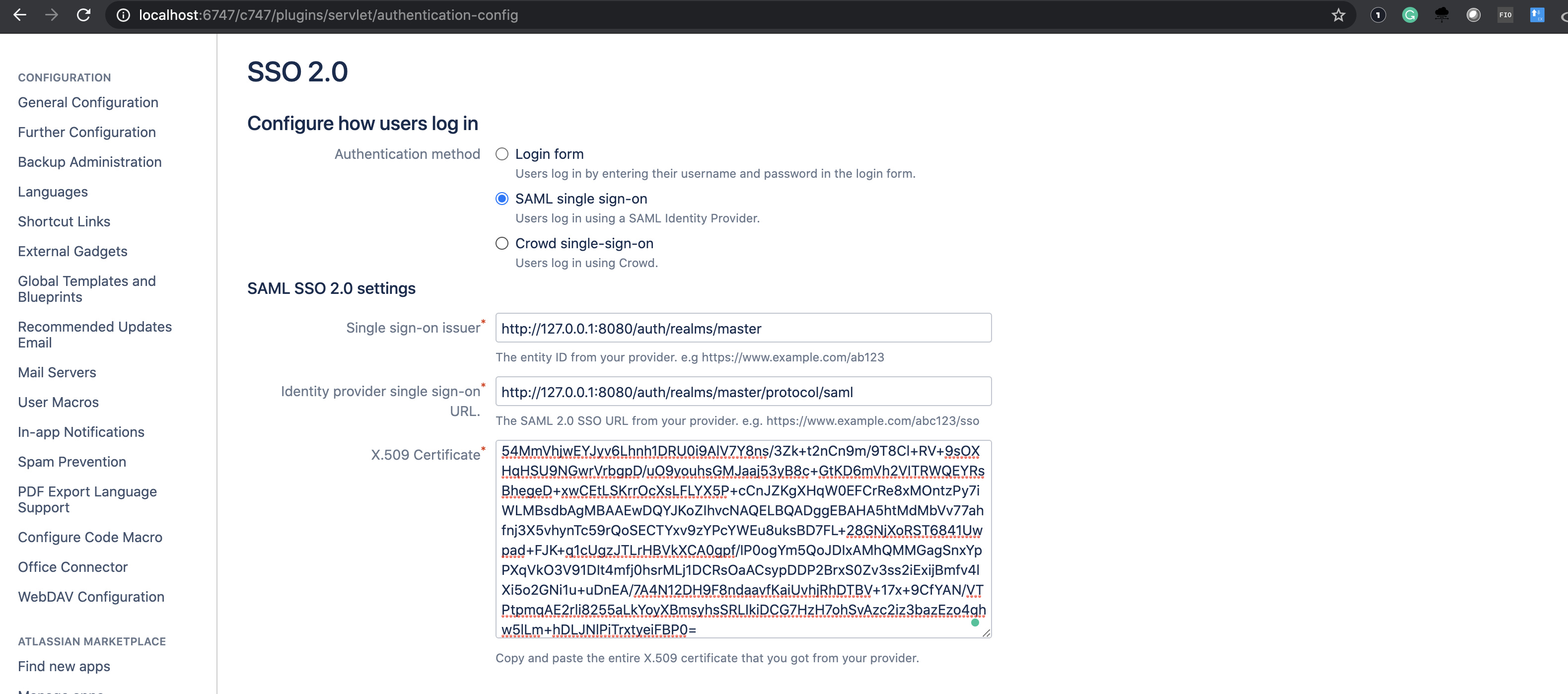

  3. This data will be used to update the SAML configuration in Atlassian products:

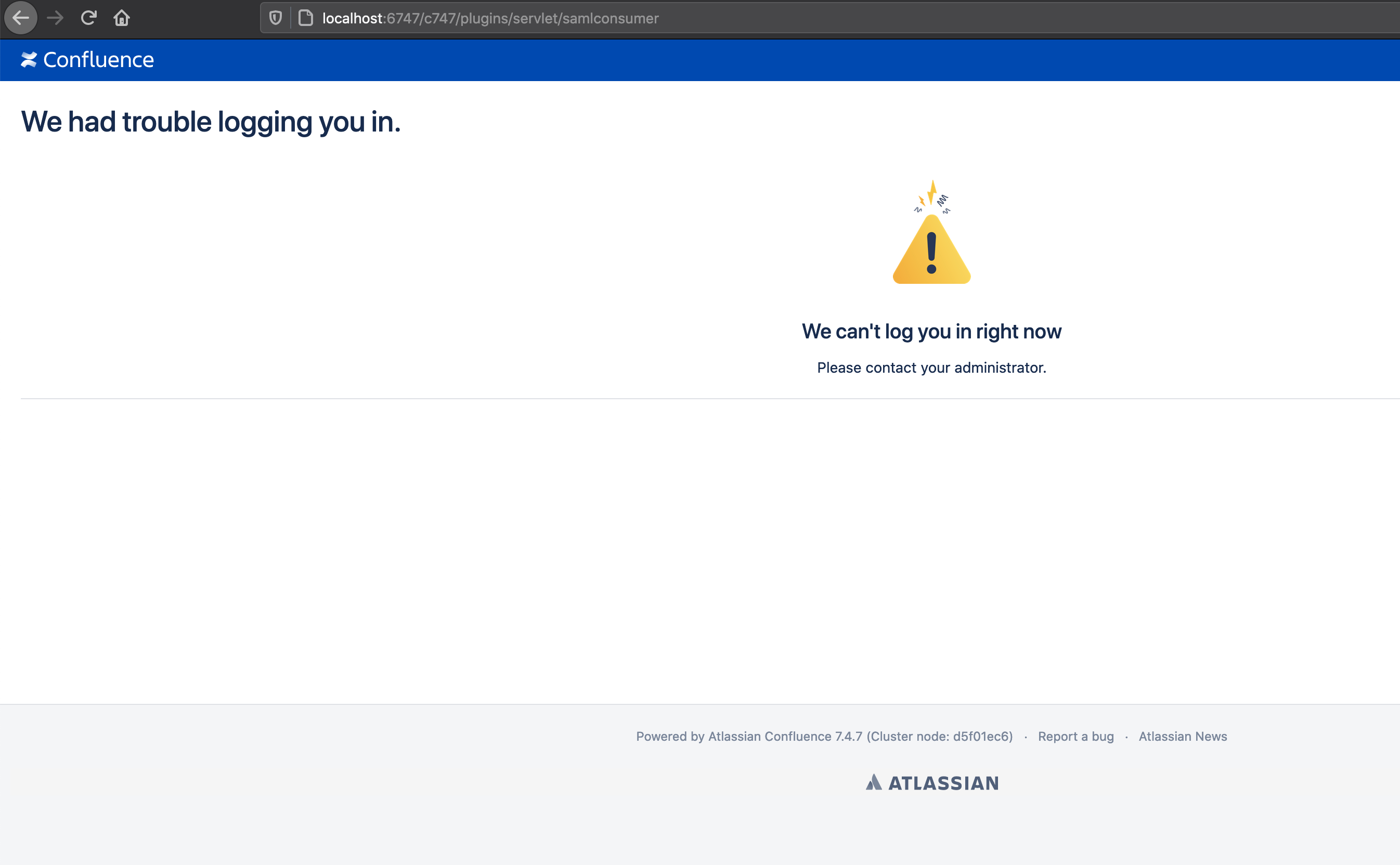

    If you receive an error message like the one in the image below after logging, check if the user exists in the Atlassian application and if it has the right permissions to view the content. If that does not help, inspect the Atlassian logs for that product for the exact error.
