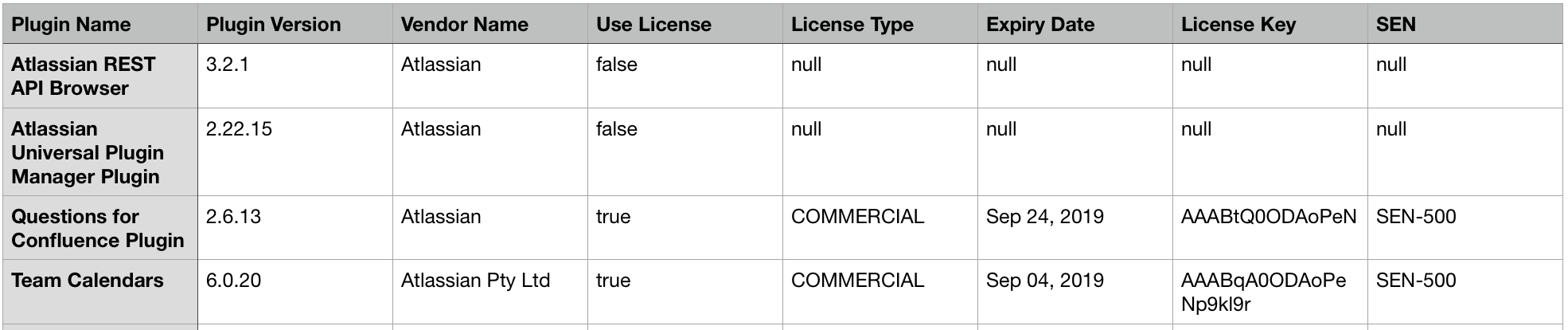

Below is an example of a report after pasting it in a spreadsheet application.
