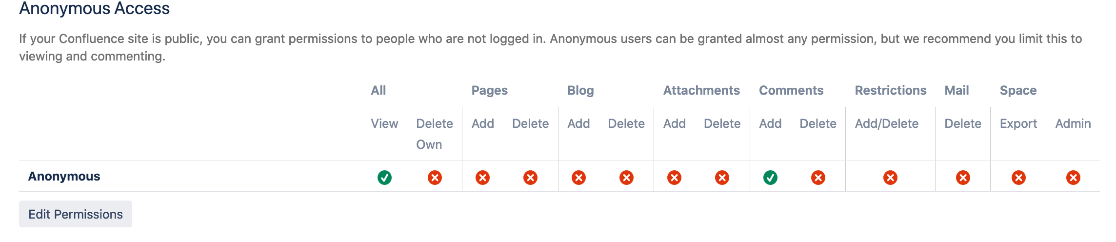

When we enable Anonymous access in Confluence at Space level, we can assign various permissions to the anonymous users. The anonymous access permissions look like below on Confluence UI.
  • (Auto-migrated image: description temporarily unavailable)
Mapping these permissions to the Database, we have below mentioned permissions specifically for Spaces having Anonymous access on.
