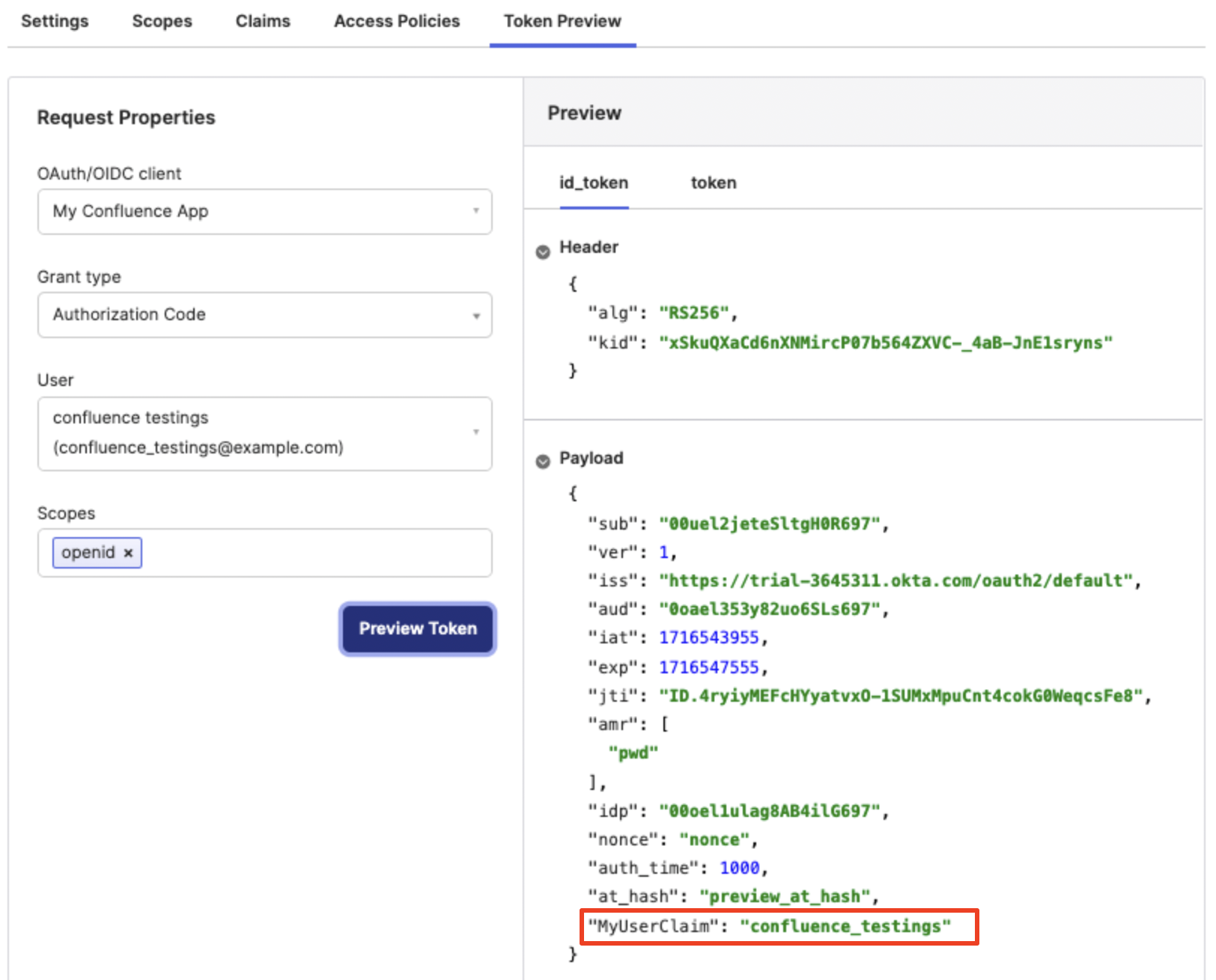

Now, it is time to validate that previous expression returns the result expected. Browse to Token Preview tab and verify the new claim is included in they Payload. See example below:
