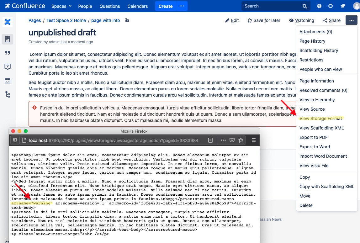

The first thing you need to do is to determine the name of the macro you want to replace on the target pages. You will also need the name of the new macro.
You can get this information by accessing the Confluence Storage Format of pages using the target macros.
The image below shows an example with the Info, Tip, Note, and Warning Macros.
Example with the Info, Tip, Note, and Warning Macros.
