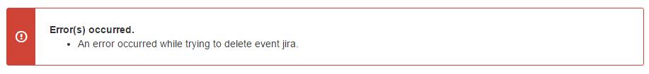

When trying to delete or edit an event in Team Calendar, the following error is thrown in the UI:
