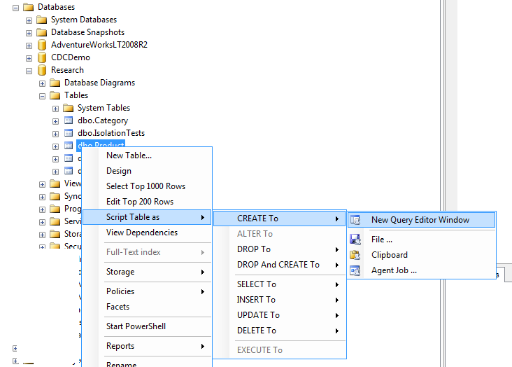

After you had confirmed that your database's collation is configured correctly, please kindly check if you are running on SQLAccess schema
In Object Explorer, expand your server/database, expand Tables, right-click the table in question, and choose Script Table as > CREATE To > New Query Editor Window.
If you want to script multiple tables, you can turn on Object Explorer Details (F7 or from the View menu), highlight "Tables" on the left, then use Shift+ or Ctrl+ to select multiple tables in the right pane (just like you would select multiple files in Windows Explorer). Then you can do the same thing, right-click, Script Table as >
