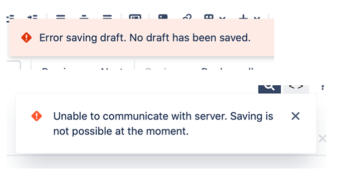

While editing a page in Confluence, the following errors may appear.
Error saving draft. No draft has been saved.
or
Unable to communicate with server. Saving is not possible at the moment.
Screenshot of the issue:
This only occurs to specific pages, while other pages can be created or modified.
