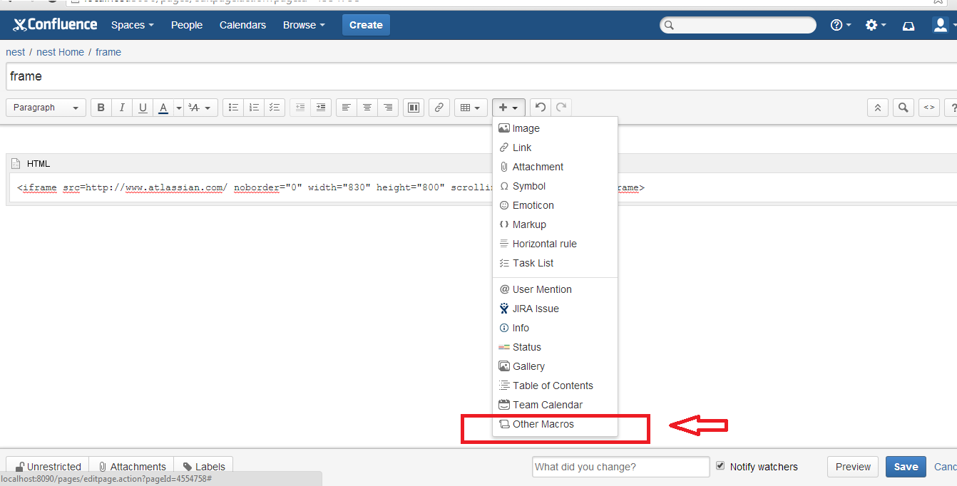

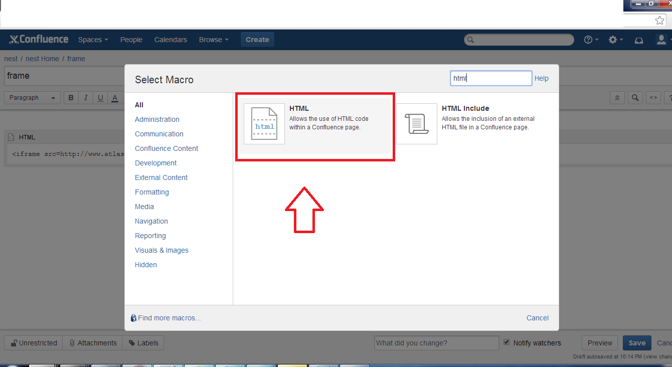

  7. The HTML macro is now available. When creating or editing a page, insert the "HTML" macro:
    1. Go to + (Insert more content) > Other macros
    2. Search for the HTML macro
    3. Paste the following code inside the macro, adding the URL of the Grafana Dashboard in src that needs to be dispalyed on the Confluence page. Modify the other parameters as required.
      1 <iframe src="Grafana Dashboard URL" noborder="0" width="830" height="800" scrolling="yes" seamless></iframe>
  8. Save the page
