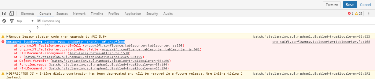

As there are no visible signs of the ERROR in the logs, and the problem appears within the browser, the best method to diagnose the issue appears within the browser itself. Using the method described in Generating HAR files and Analysing Web Requests, generate a HAR file while attempting to edit the page. By reviewing the Console (as shown below) of your Developer Tools, you should see an ERROR message that appears in the Developer Tools or Console in-browser. In the example shown, the issue is discovered in a Bob Swift Advanced Tables plugin version 7.3.0, but this has also appeared in Bob Swift Table Library version 3.1.0 and was corrected in Table Library version 3.4.0. This is described in TBLSORT-71 - tablesorter.js throws type charAt could not be defined exception when enable column sort is turned off.
You will see an ERROR message similar to:

There is a parameter within the two macros known to have experienced this issue that when unchecked, causes the resulting ERROR to occur. The problem is that if the auto sort column value is populated and the parameter enable column sorting has been unchecked in the macro, the editor will display a blank page. Nothing will be displayed to the user.
Solution
Workaround
You can resolve the issue by checking the enable column sorting parameter in the macro again. The editor will then render the page properly, as the javascript ERROR is no longer thrown in the page.
