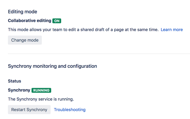

When the keys are not received by Synchrony, but Collaborative Editing is enabled, the Collaborative Editing admin page may show a green status for both Synchrony and Collaborative Editing:
However, editing pages or creating new pages will still fail with this message:
This page is taking longer to load than usual. Give it a few moments, then try refreshing. Still having issues? Contact your Confluence admin.For further testing and a temporary workaround until the infrastructure issue can be resolved, see the Temporary Workaround section below.
