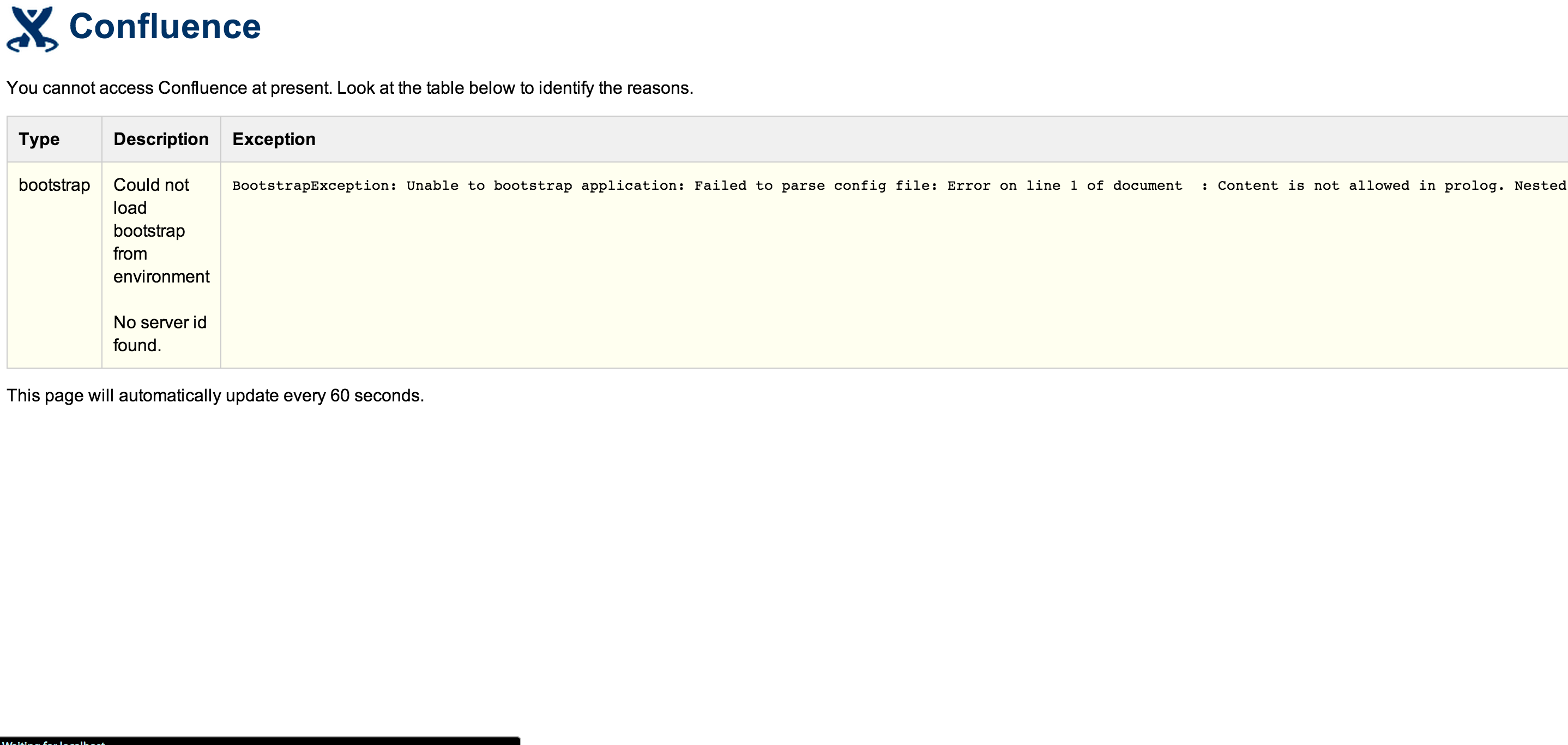

Confluence will not start although Tomcat starts without issue. Nothing is reported to the atlassian-confluence.log.
When hitting the baseURL, confluence reports a Bootstrap exception: Unable to bootstrap application, Failed to parse config file: Error on line 1 of document : Content is not allowed in prolog.
No server id found.
