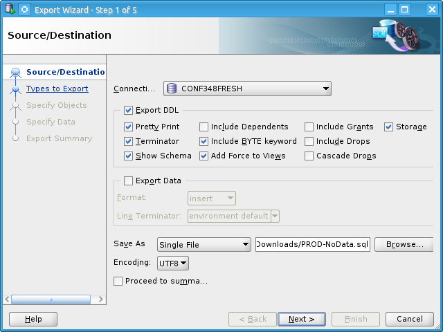

  1. Setup a fresh Confluence 3.4.8 using Oracle database
  2. Export the DDL only using Oracle SQL Developer's Export Tools by unticking the Export Data

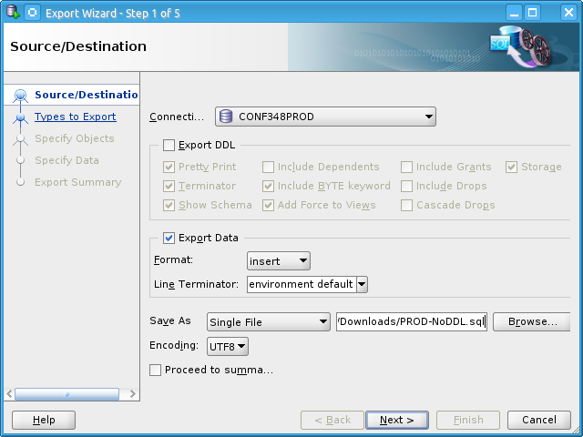

  3. Export the data of your Confluence 3.4.8 production database by unticking the Export DDL
  4. Import PROD-NoData.sql to the new database
  5. Import PROD-NoDDL.sql to the new database
