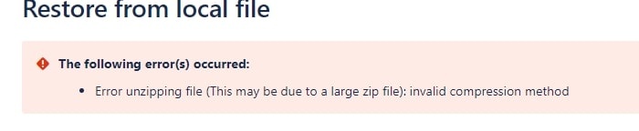

Space import failed with Error unzipping the file (This may be due to a large zip file): invalid compression method
