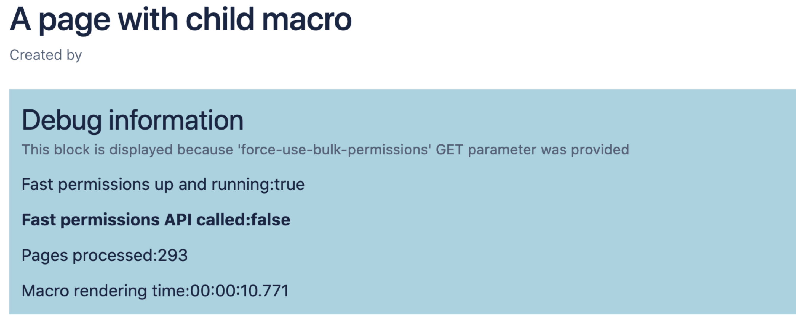

đź’ˇ The other way to do it is to temporarily disable the faster permissions for one page that has the misbehaving macro and see if it helps. For this we can use the especial GET parameter "force-use-bulk-permissions" in the page URL. Like this:
https://your_base_url/confluence/display/TEST/A+page+with+child+macro?force-use-bulk-permissions=false https://your_base_url/confluence/pages/viewpage.action?pageId=12345&force-use-bulk-permissions=false
ℹ️ Remember change the URL to match yours.
ℹ️ Adding this parameter also displays a special frame with the debug info that should help troubleshooting:
