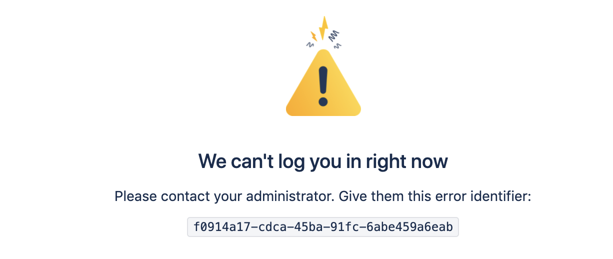

When trying to authenticate a user using SSO SAML integration for Confluence Data Center with IDP fails with the below error :
in the logs(atlassian-confluence.log), We see the below errors:
2021-08-18 13:11:18,299 ERROR [http-nio-7990-exec-1] @VS5T83x791x77x0 X.X.X.X,127.0.0.1 "POST /plugins/servlet/samlconsumer HTTP/1.0" c.a.p.a.i.w.f.ErrorHandlingFilter [UUID: f0914a17-cdca-45ba-91fc-6abe459a6eab] Received SSO request for user <username or email>, but the user does not exist com.atlassian.plugins.authentication.impl.web.usercontext.AuthenticationFailedException: Received SSO request for user <username or email>, but the user does not exist at com.atlassian.plugins.authentication.impl.web.saml.SamlConsumerServlet.lambda$doPost$2(SamlConsumerServlet.java:112)

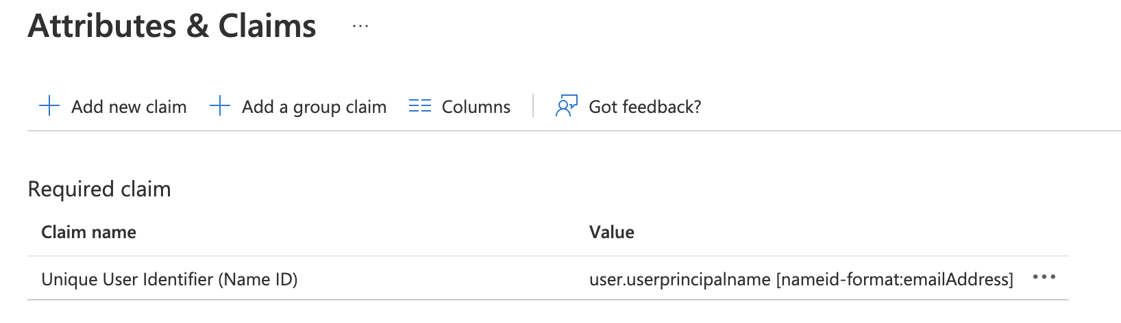

  2. Navigate to Attributes & Claims and click Edit
  3. Click on Unique User Identifier (Name ID).

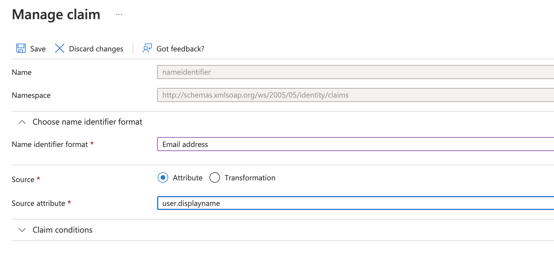

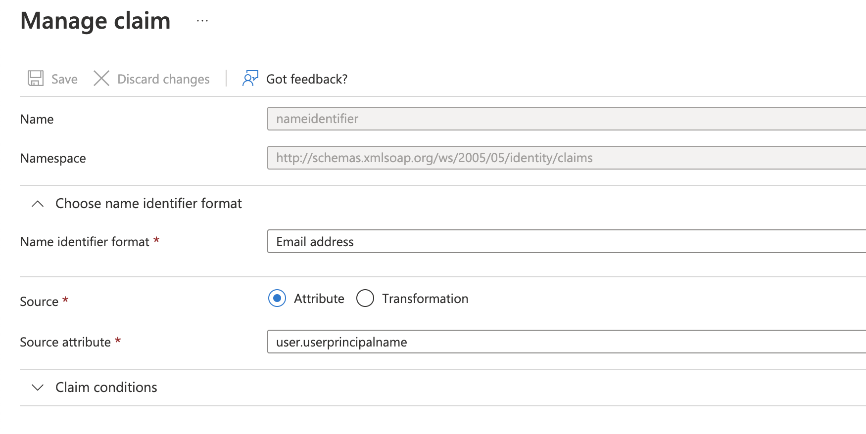

  4. Edit Unique User Identifier (Name ID) Value
    By default, the source attribute is set to user.userprincipalname attribute. This is the Email ID attribute in Azure AD. Azure AD sends the user's email ID as a NameID identifier in SAML response to Confluence.
    Prior selecting user.userprincipalname as the Source Attribute, please make sure that the values of this field match the usernames in Confluence. Otherwise, select some other attribute i.e. user.onpremisessamaccountname
  5. To change the source attribute from EMail ID to username, set the Source attribute to user.displayname. This sends the username as a NameID identifier in SAML response to Confluence.
