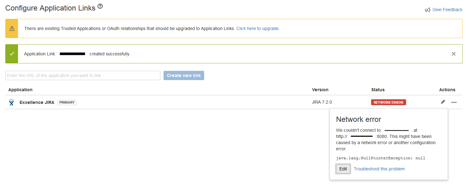

Confluence returns network error, NullPointerException while creating application link to JIRA. However, JIRA seems to be connected just fine from Confluence.

  • Both JIRA and Confluence were migrated from Cloud and now running on servers.
Diagnostic Steps
  • Application link was not able to connect even after proxy and SSL was bypassed.
  • Regardless if Confluence and JIRA are running on the same or different server.
Cause
This issue wasn't caused by the network as shown in the error message. There might be some old OAuth token in the database used in the Cloud instance that's not longer used in servers. These OAuth token needs to be removed and recreated.
