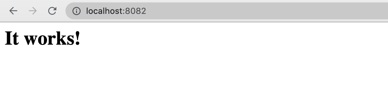

You can also check the browser by visiting the url using this port. In the above example Nginx is running on localhost using port 8082. So if the url http://localhost:8082 is visited on browser, one can see a response similar to:

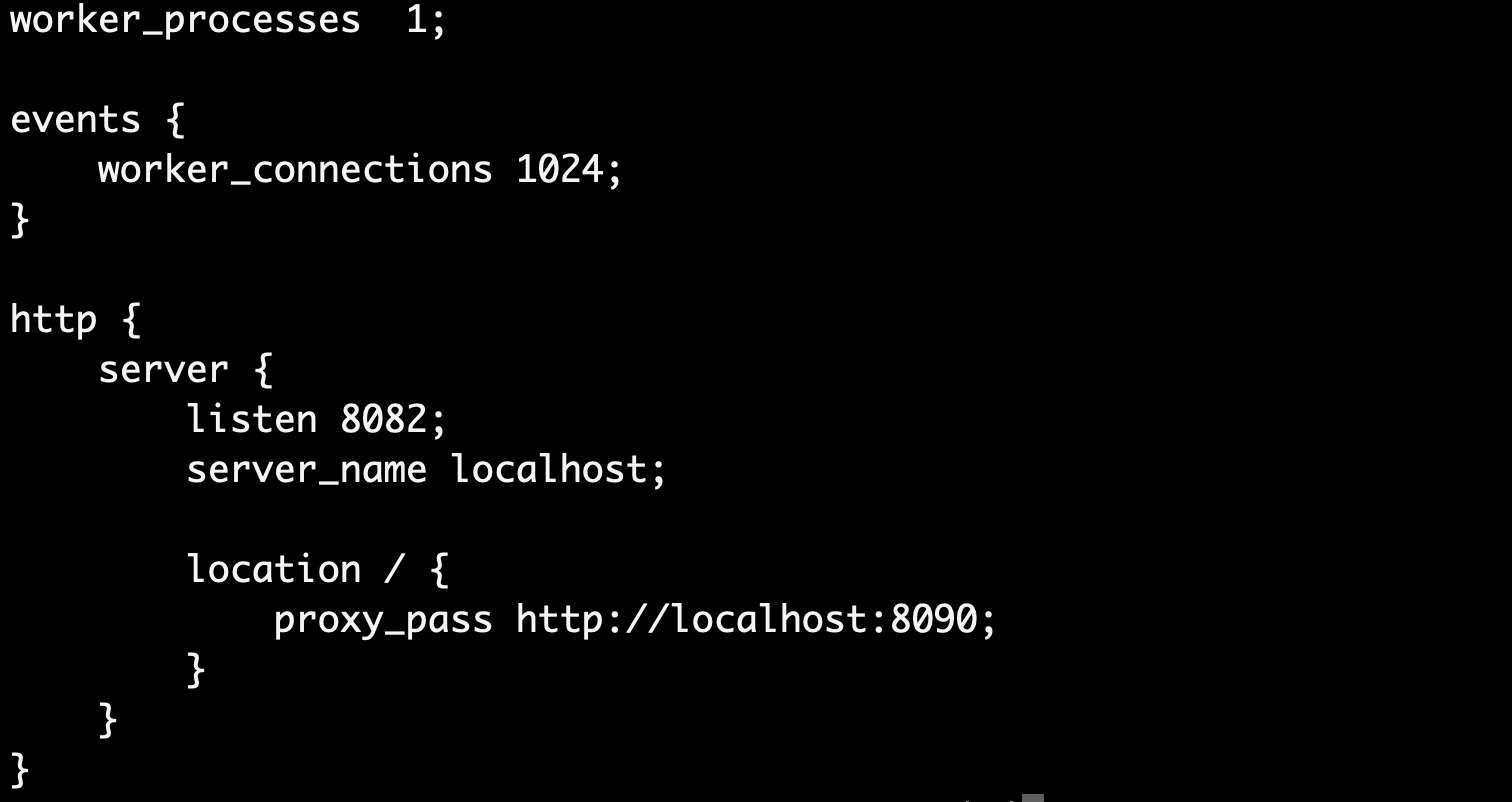

Assuming that Confluence is running on port 8090 using ip xx.xx.xx.xx , Nginx can be directed to receive traffic on a domain url and then direct this traffic to Confluence ip and port. For example, consider a very simple nginx.conf configuration like below:
In the above sample, Nginx listens to port 8082 for the server url "localhost". Please ensure to use the correct syntax for the nginx.conf file. Even a minor infraction of the syntax will cause the server to not start and this could make life very difficult if the .conf file is really large and has many blocks of inner settings. Ensure that the curly braces are all matched and the ";" is present after the end of every value. We will look at each relevant value and how it functions from the above sample:
Under the Server block, we have the:
listen 8082 : This ensures that Nginx listens to port 8082
server_name localhost : The domain url to which Nginx listens to. This could be an ip address or a meaningful domain name such as example.com etc. Which should resolve to an ip if a dnslookup is performed.
location / : This is the location where the context value can be configured. If a context value is provided for Confluence under the server.xml file, you can use this config to route traffic relative to that Context value. We will see more about this later. Here there is no context value set, but just a simple "/". Which means that any user visiting http://localhost:8082 will be directed to the url under proxy_pass. In this case, it is http://localhost:8090. Which is the url where Confluence is currently running.

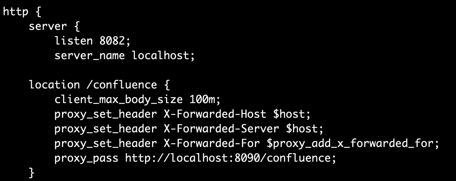

If a context has been set for Confluence in the "Context" tab in the server.xml file, then one can use a nginx.conf file, like the one below:
The location /confluence will ensure that any traffic that is received in the url http://localhost:8082/confluencewill be routed to the url http://localhost:8090/confluence. But this configuration should only be done if the Context value is set in the server.xml as explained before.

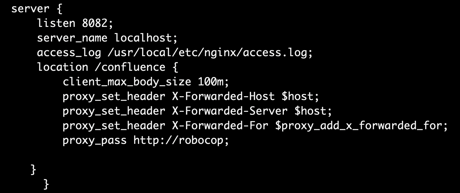

Simple Load Balancing with Nginx for Confluence
One of the most important features of a reverse proxy server such as Nginx is to provide support for load balancing. This is useful for Data Centre instances where the incoming traffic can be routed to different nodes. Nginx out of the box supports different types of load balancing logics and these can be used depending upon the type of the application and the kind of traffic balancing based on usage. A typical round robin load balancing does not require much configuration and a simple configuration can be deployed as below:
The "upstream" block depicts the servers that are part of the node. Assuming that Confluence is running on two nodes each as specified using the server keyword, the above configuration will route traffic in a round robin fashion between these two servers. The default setup of traffic routing will be round-robin. But any another routing mechanism is needed, different load balancing options can be used as described in this article here: Nginx : Different load balancing options. For example, a configuration like the below:
Load Balancing Options
1 2 3 4 5 upstream myloadbalancer { least_conn; server backend1.example.com; server backend2.example.com; }
The "least_conn" option specifies that the incoming connections will be routed to the server that has the least number of connections. Please note that a name for the loadbalancing block is used. For the above sample, this name is "myloadbalancer" and similarly for the previous example, this was "robocop". Users need to ensure that this identifier name is used within the proxy_pass value within the location block to ensure that load balancing works as expected. Also note the usage of "http:" prefix for the load balancing identifier name. Missing these details might cause the Nginx server not to start. As noted above, minor syntax errors will cause the nginx not to start and it might be difficult to locate the lines that are causing the server to fail. But Nginx does offer a variety of logging options that can help identify errors. For example, note the below sample conf file:

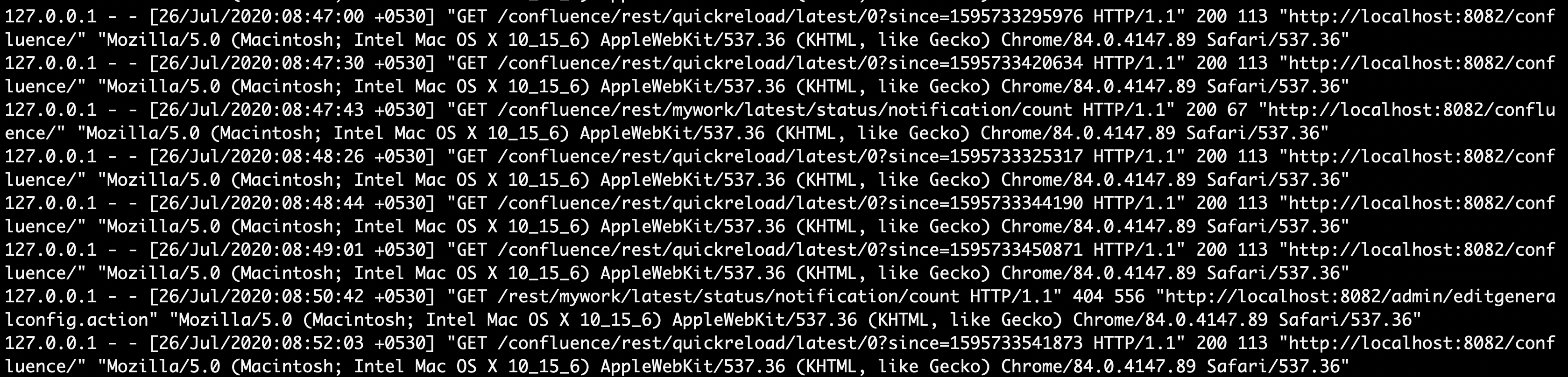

In the above sample, the access_log usr/local/etc/nginx/access.log specifies the location at which the access log for nginx will be stored. All usage data such as a referrer, times, device information etc will be captured and stored in these files. There is also a similar "error_log" tag that can be used only to capture error information. For example when a user tries to access a resource that is not present, then an error log is added here. Below is a sample access_log data:
This typically captures all the data that can be extracted. But this log information can be formatted so that only desired data is obtained. This can be done by adding:
