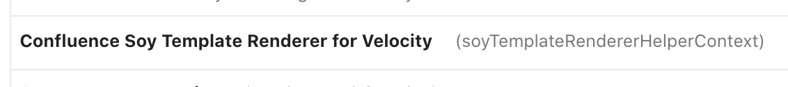

The "Confluence Soy Template Renderer for Velocity" module (soyTemplateRendererHelperContext) for "Confluence Soy Template Support" plugin gets disabled.
The behavior is described on the following bug: CONFSERVER-22390 - Plugin's velocity module is disabled by Confluence.
Resolution
Re-enabling the affected module should get rid of the issue.
Image 2 - Plugin:
Image 3 - Module:
đź’ˇ PS: also ensure that all modules for "Confluence Soy Template Support" plugin are enabled.
