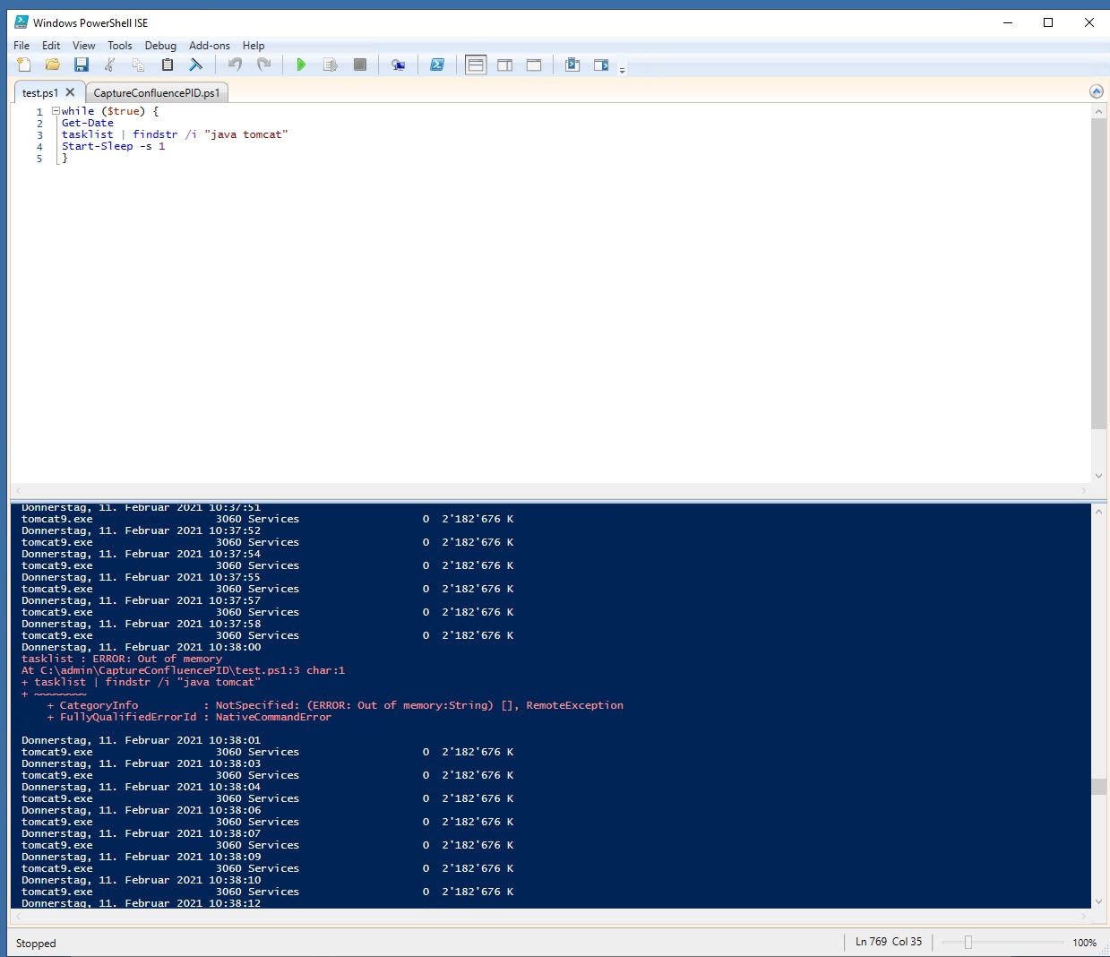

Synchrony keeps on checking for process of Confluence and terminates itself when it can't find Confluence's PID. The log message states that Synchrony has been looking for process ID of Confluence (3060 in above log snippet) and can't find it. So, as a result the process of Synchrony dies.
Synchrony looks for PID of Confluence via tasklist.exe. In some versions of MS Windows tasklist doesn't work properly and returns Out Of Memory errors.
A simple script like follows can be used to check whether tasklist runs properly in OS or not.
Save it as .ps1 file and execute
while ($true) { Get-Date >> taskList.txt tasklist | findstr /i "java tomcat" >> taskList.txt Start-Sleep -s 5 }
ℹ️ The process of Confluence runs as tomcat and process of Synchrony as java
If the tasklist command errors out, Synchrony will keep on terminating (because it thinks that Confluence has died).
